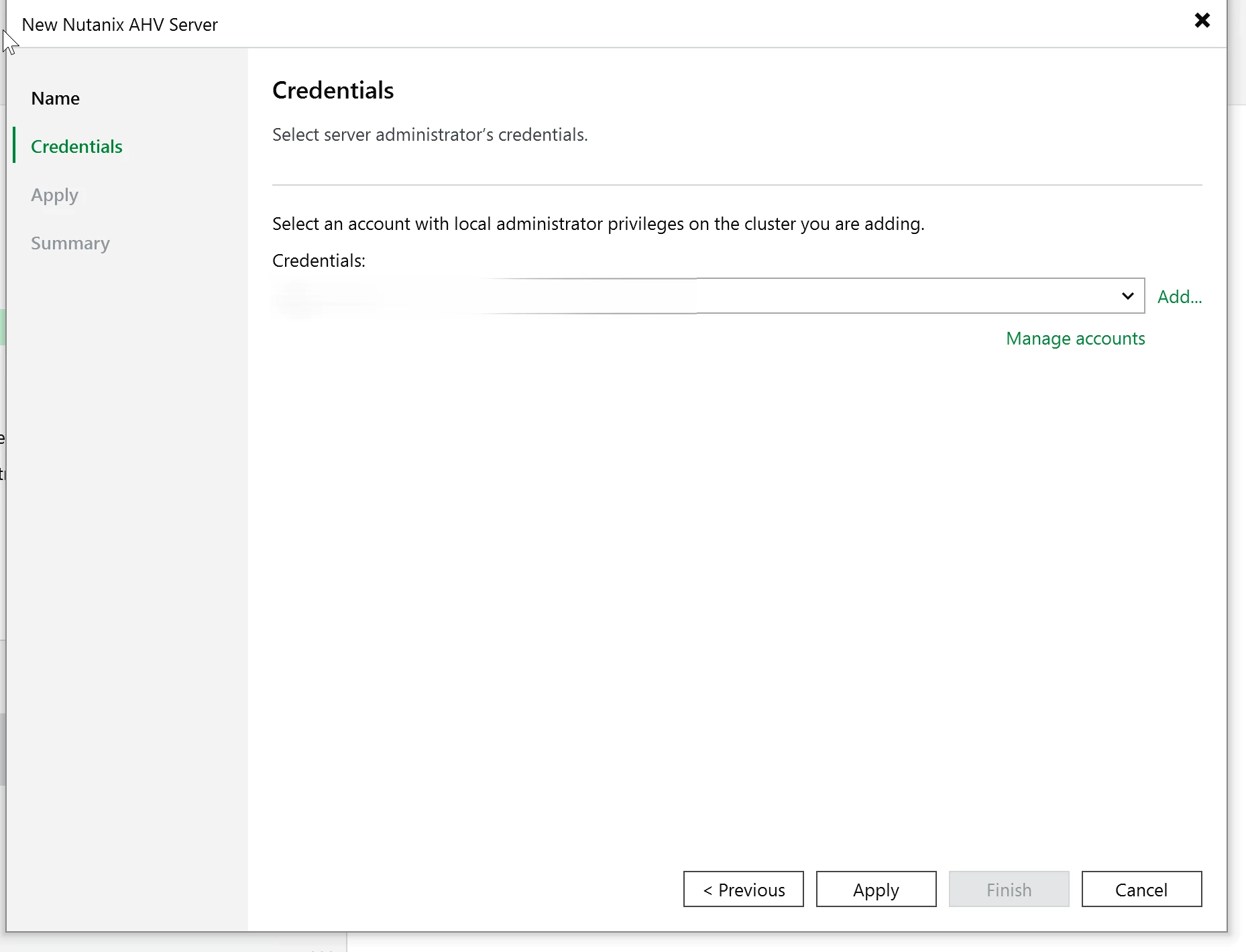

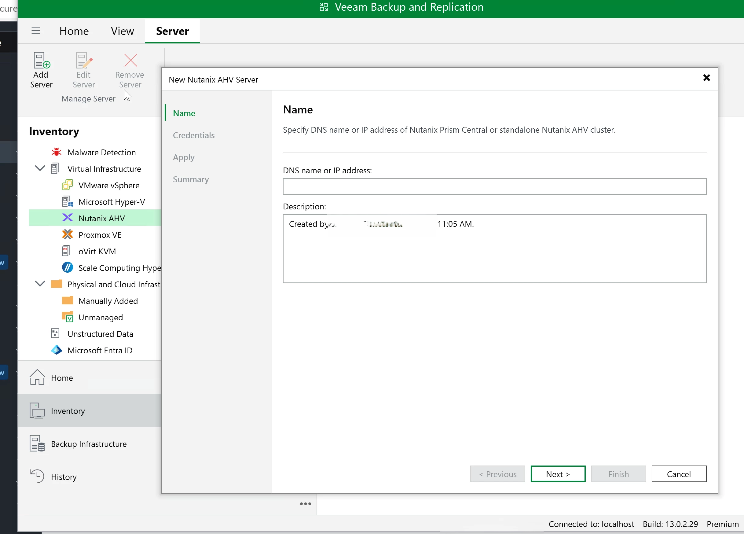

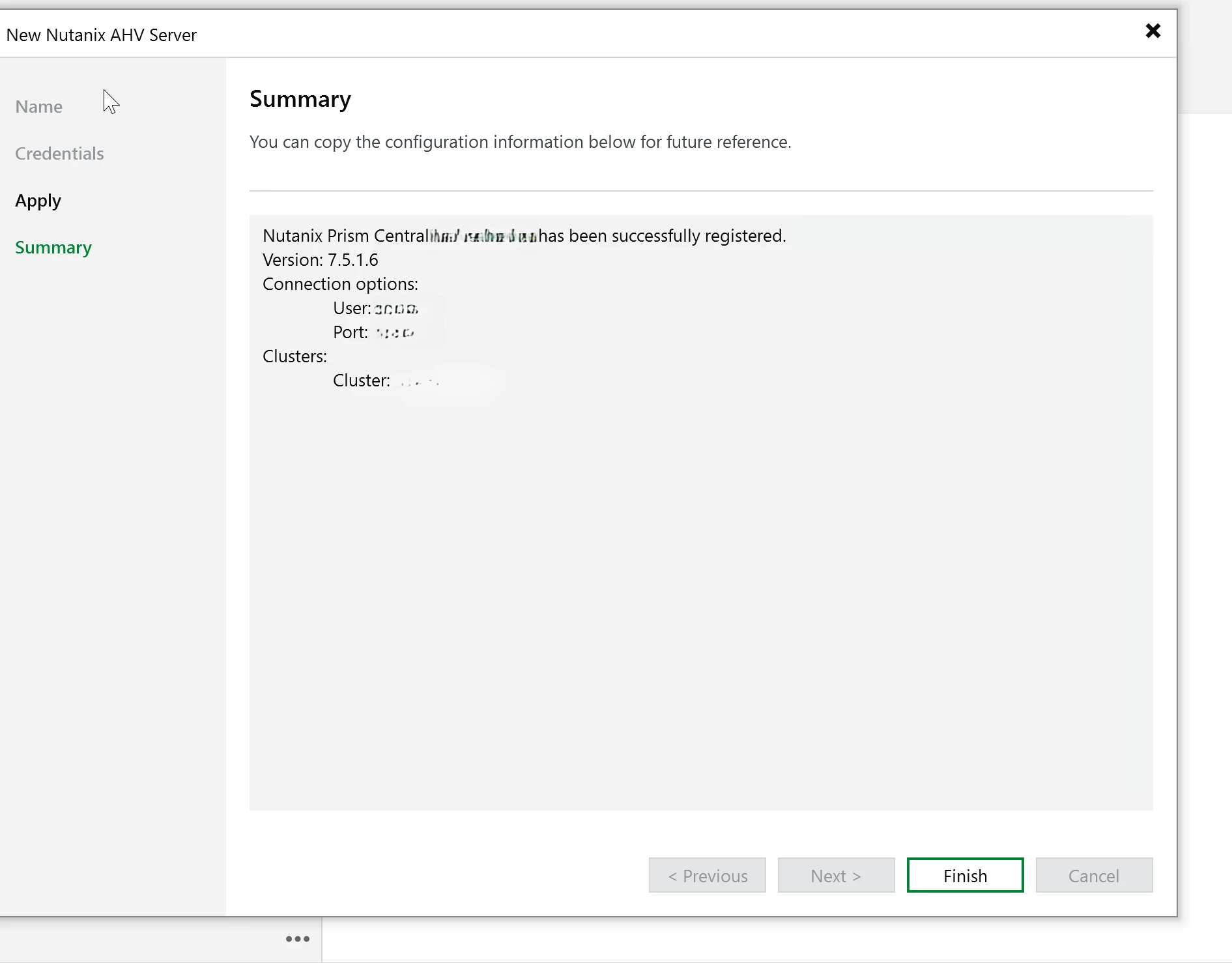

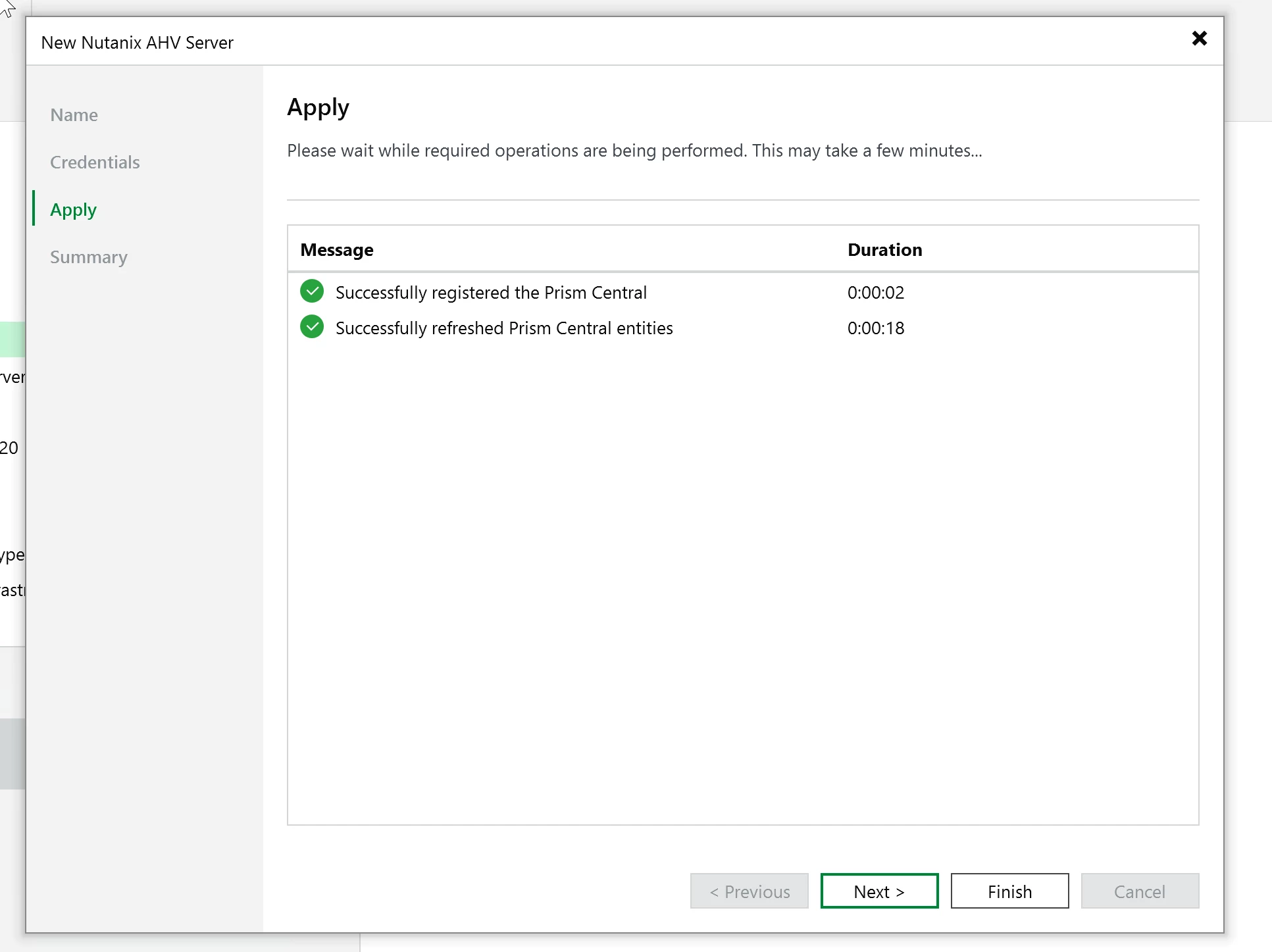

In the VBR console, go to Backup Infrastructure. Right-click Add Server, then choose Nutanix AHV.
Enter the IP address or FQDN for Prism Central or Prism Element, click next, then provide the admin credentials.
VBR validates the connection and pulls the cluster topology. Confirm what it found and continue.

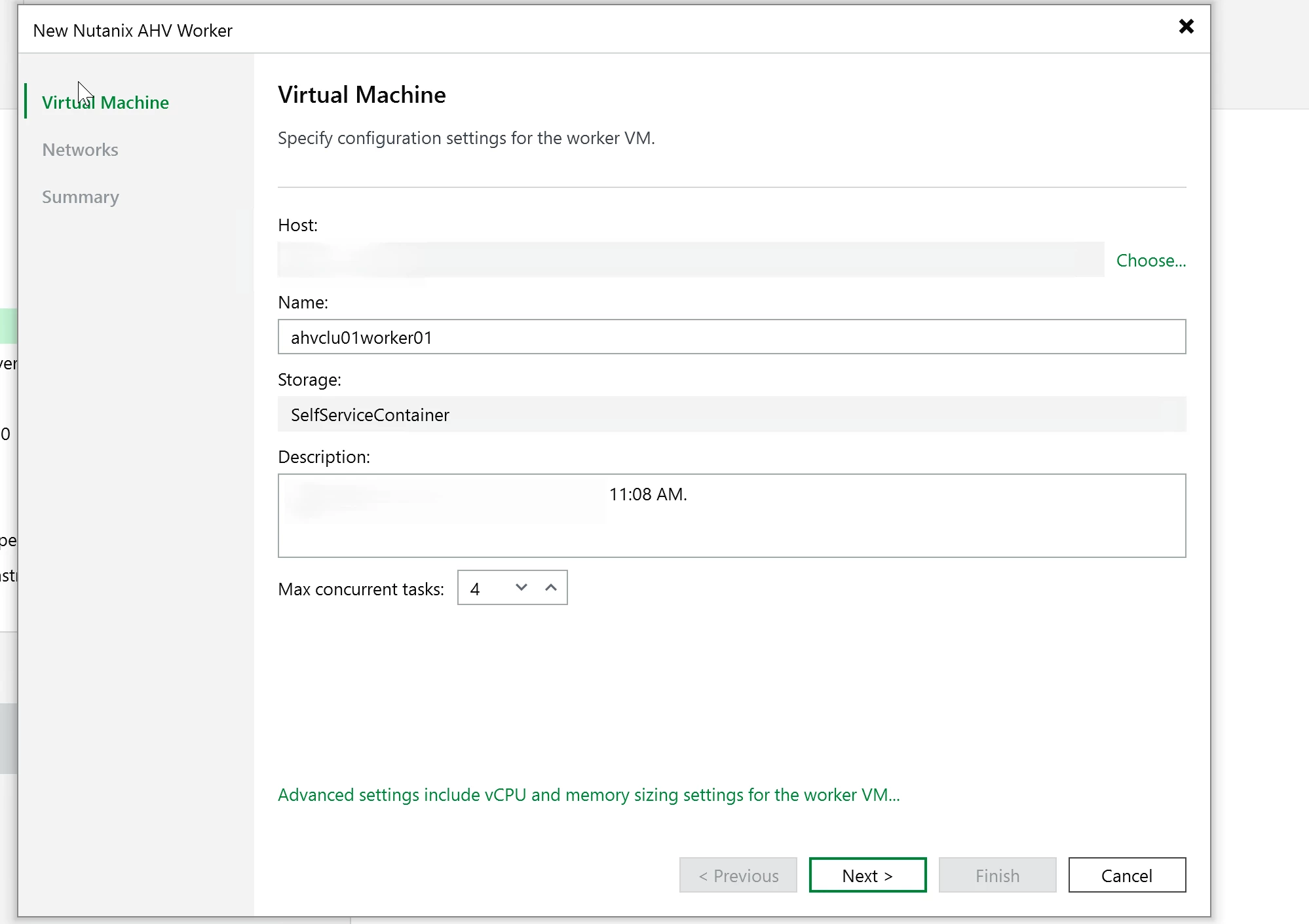

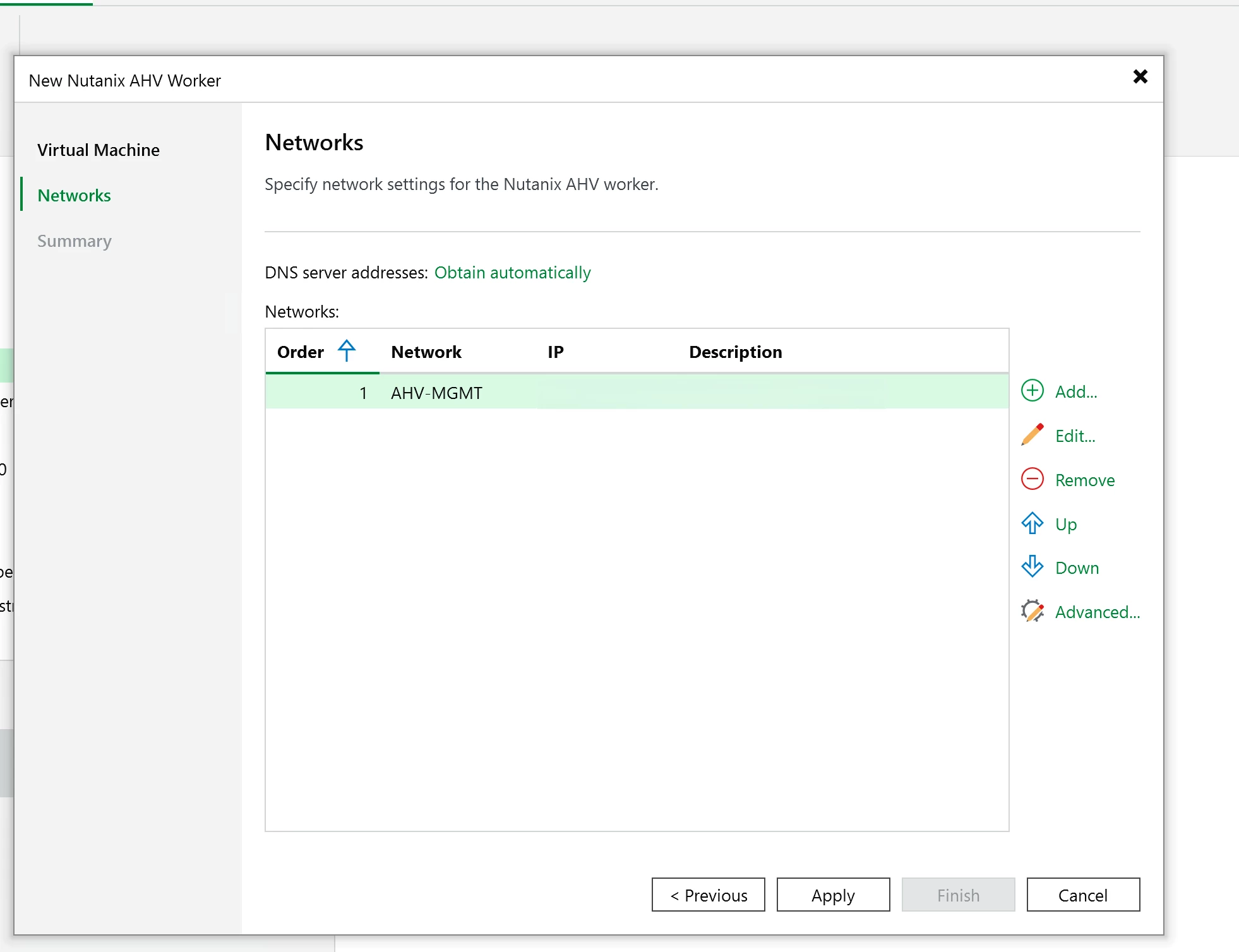

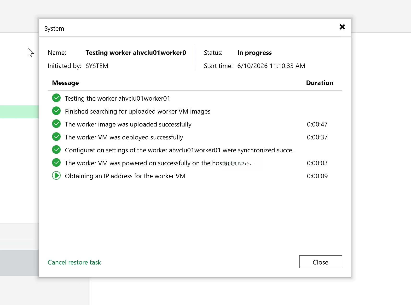

Workers are Linux-based VMs that VBR uses for data movement. They read from the Nutanix environment and send backup data to the repository. You configure them from the VBR console under Backup Infrastructure and Backup Proxies.
The worker setup is pretty straightforward. Pick the Nutanix environment, set the worker name, choose the storage container, configure networking, and set host affinity if you need it.
Click Apply and let VBR save the configuration. When a backup or restore session needs a worker, VBR brings it online for the job. When the session finishes, the worker shuts back down.
Click Apply and let VBR create the VM, boot it, config networking, and register it to the backup server. Expect this to take a few minutes..
Worker planning note: size and place workers per AHV cluster. Veeam recommends deploying workers in each Nutanix AHV cluster you protect. If no worker exists in a cluster, VBR can use a worker from another cluster, but the backup performance can be affected by doing this.

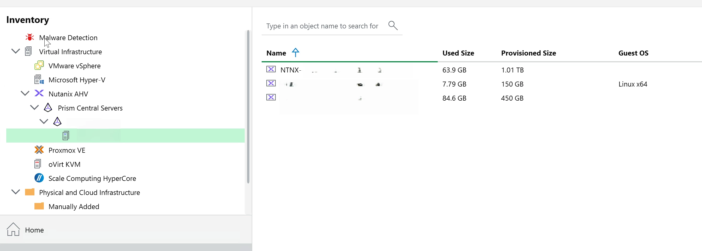

Check Backup Infrastructure after the Nutanix environment is added. Your Nutanix server should show up in VBR, and the workers should be listed under Backup Proxies. That is where you can check status, connection health, and concurrent task settings.

Need more workers? Go to backup infrastructure, then backup proxies, and run the add proxy wizard. Pick the Nutanix cluster, name the worker, choose the storage container, set networking, and configure host affinity if needed. VBR saves the worker configuration to its database. The worker VM is not necessarily deployed until testing or a backup/restore session needs it. At job start, VBR launches or deploys the worker. When the session finishes, VBR shuts it down.
The embedded worker is enough for a first test. When you need more throughput, add dedicated workers. Veeam’s sizing guidance is to allocate 1 vCPU and 1 GB RAM for each additional task, and to keep the total concurrent tasks across workers within the physical disk count of the cluster.

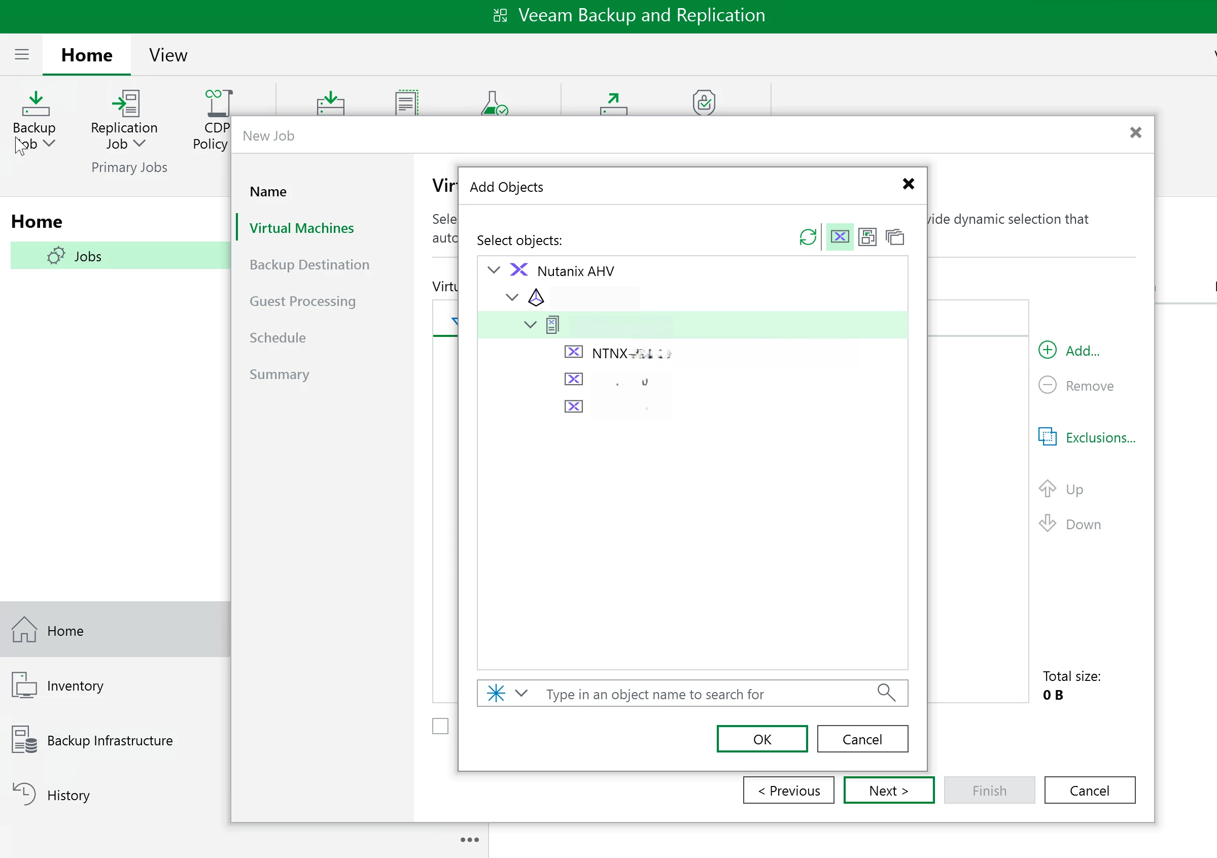

Creating the backup job
Go to home. Right click backup job, then choose Nutanix AHV. If you have built VMware backup jobs before, the wizard will feel familiar. Pick the VMs you want to protect.
For the first run, I set the schedule to manual so I could trigger it myself and watch the session log. Finish the wizard.

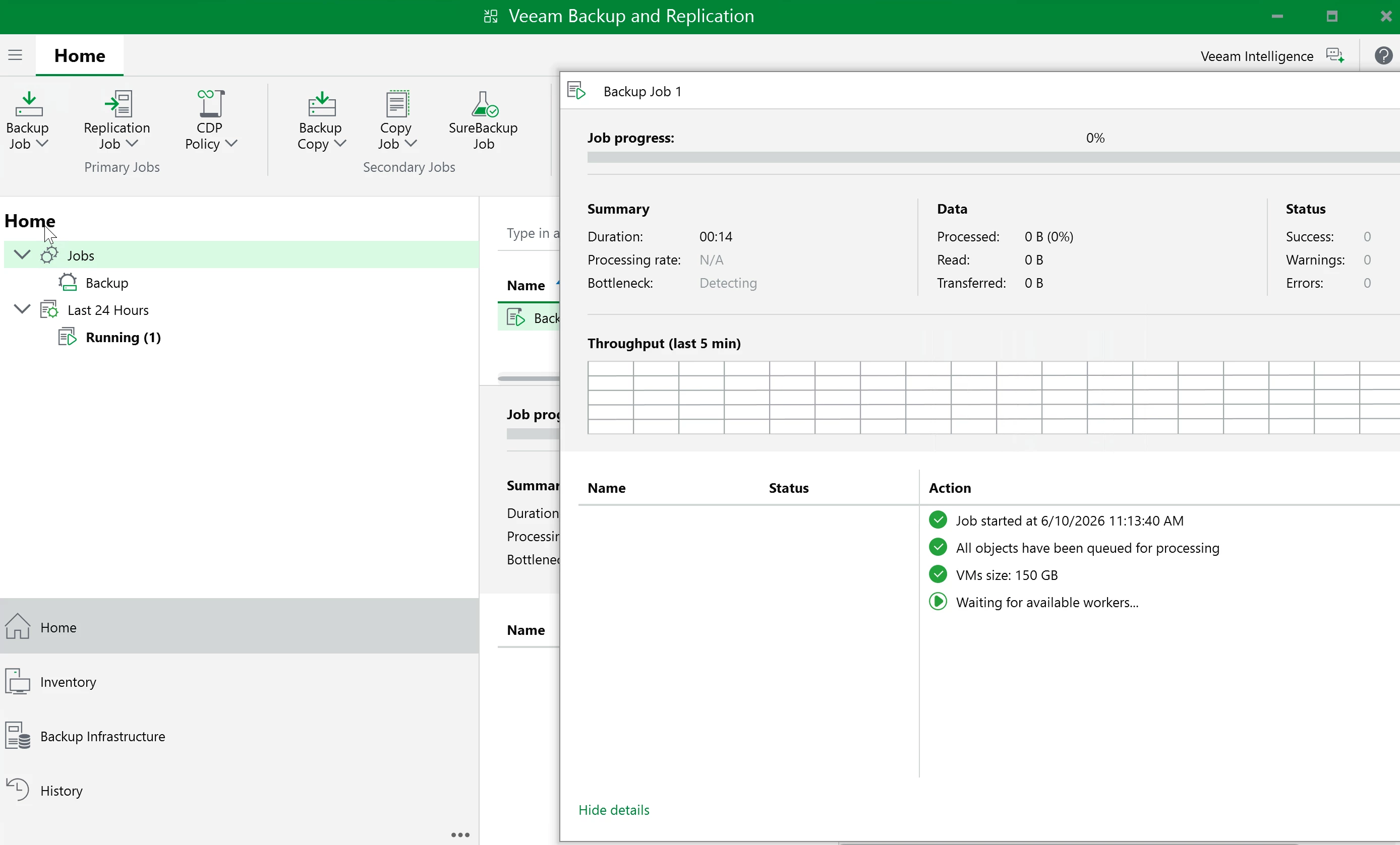

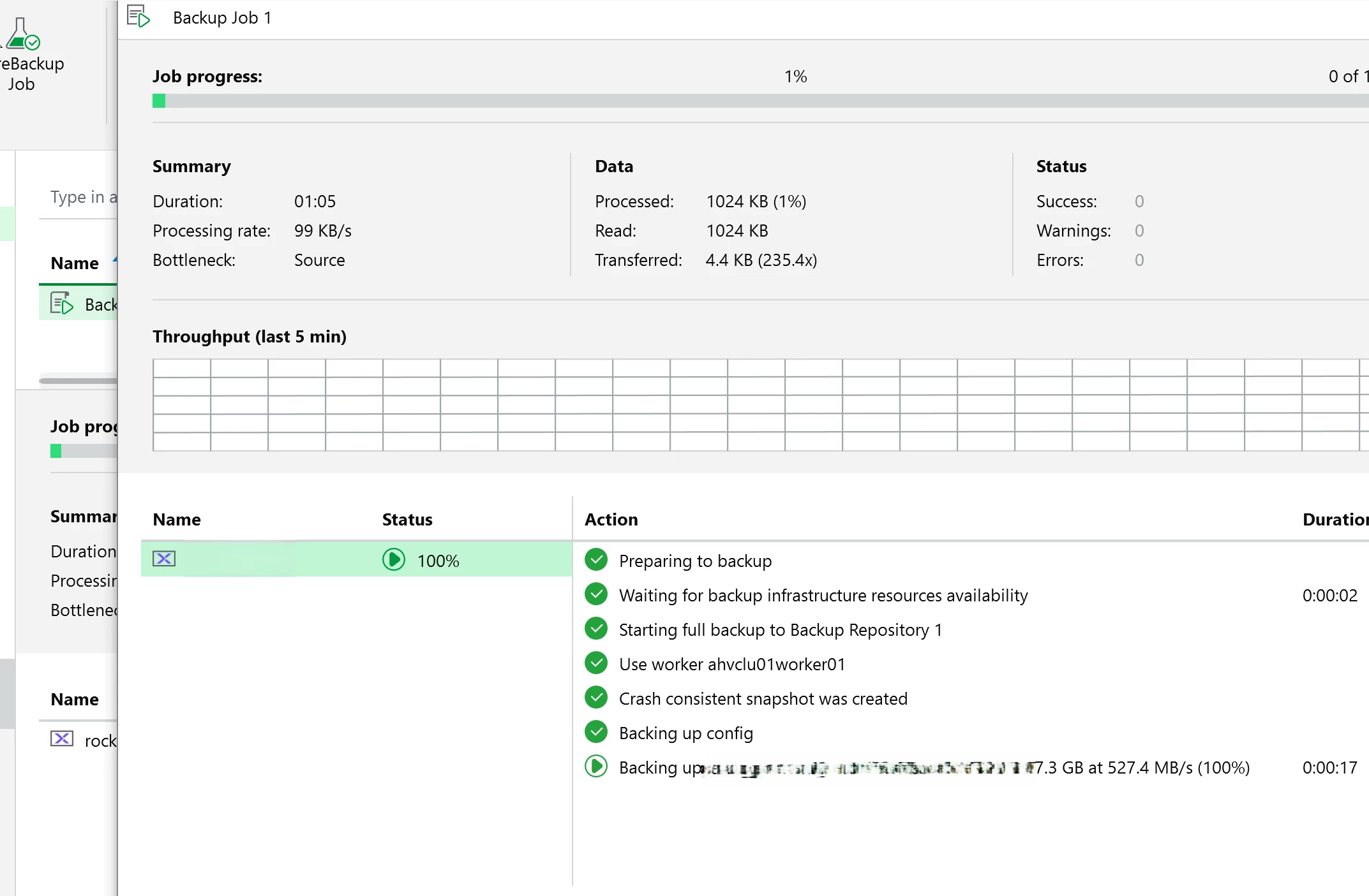

Running the First Backup
Right-click the job and start it.
Behind the scenes, the worker talks to Prism and uses Nutanix snapshots. On the first run, Veeam reads written blocks while filtering out unallocated blocks. On later runs, Veeam compares the current snapshot with the previous backup snapshot so it can read only the changed blocks through Nutanix CBT.
After the job finishes, review the session log. Check throughput, data transferred, bottlenecks, and warnings. Be aware that Veeam managed backup snapshots are part of the AHV backup workflow and CBT behavior. Do not manually remove Veeam-managed recovery points unless you are doing it intentionally.

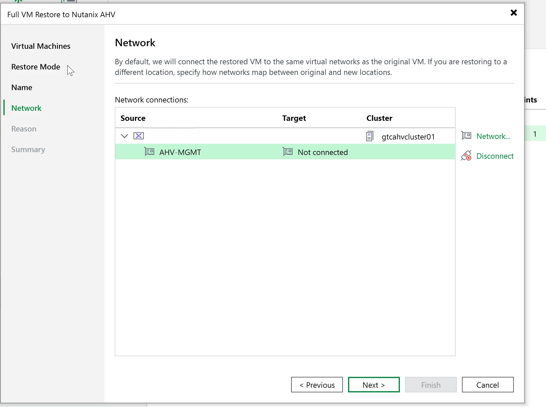

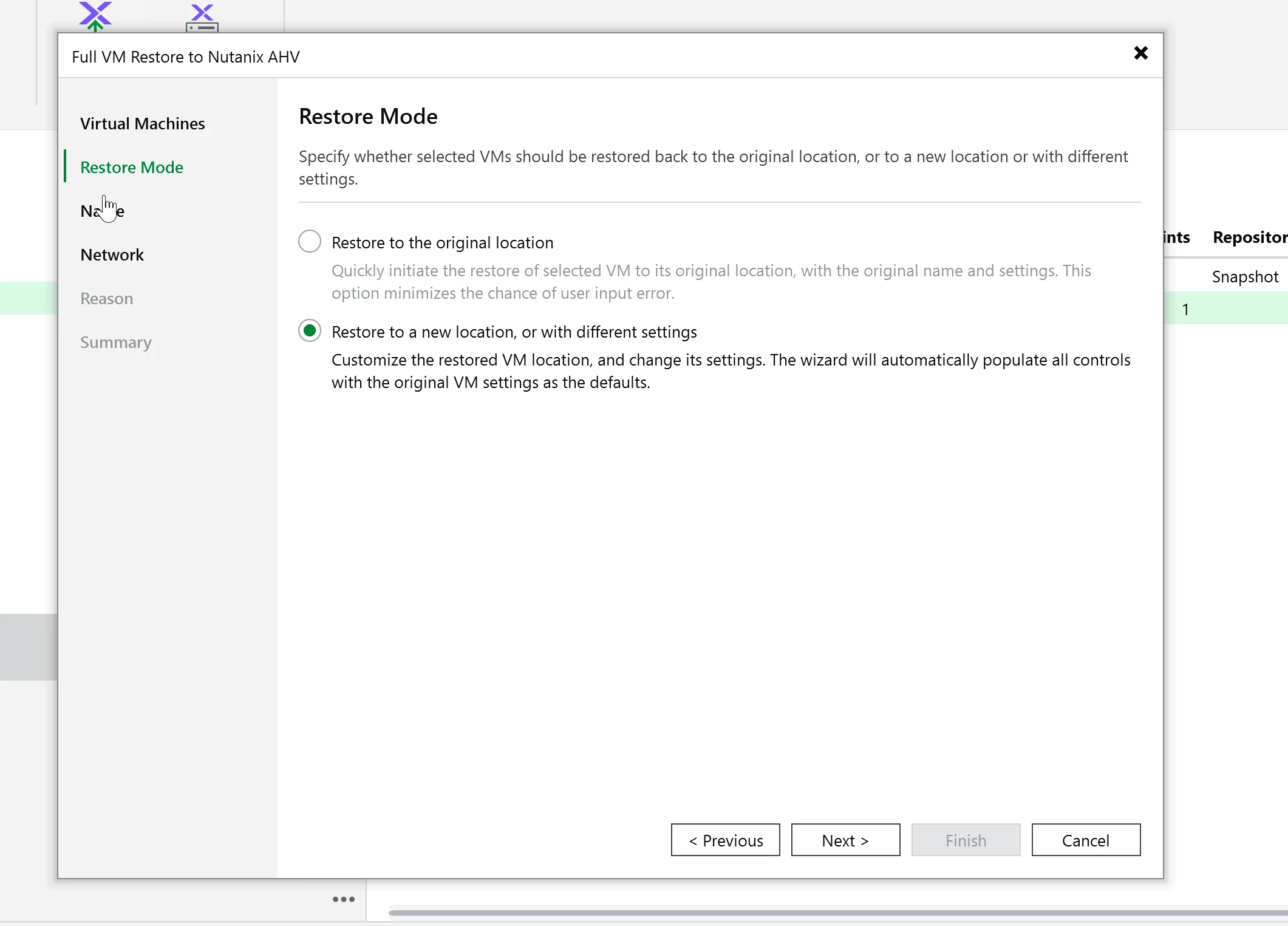

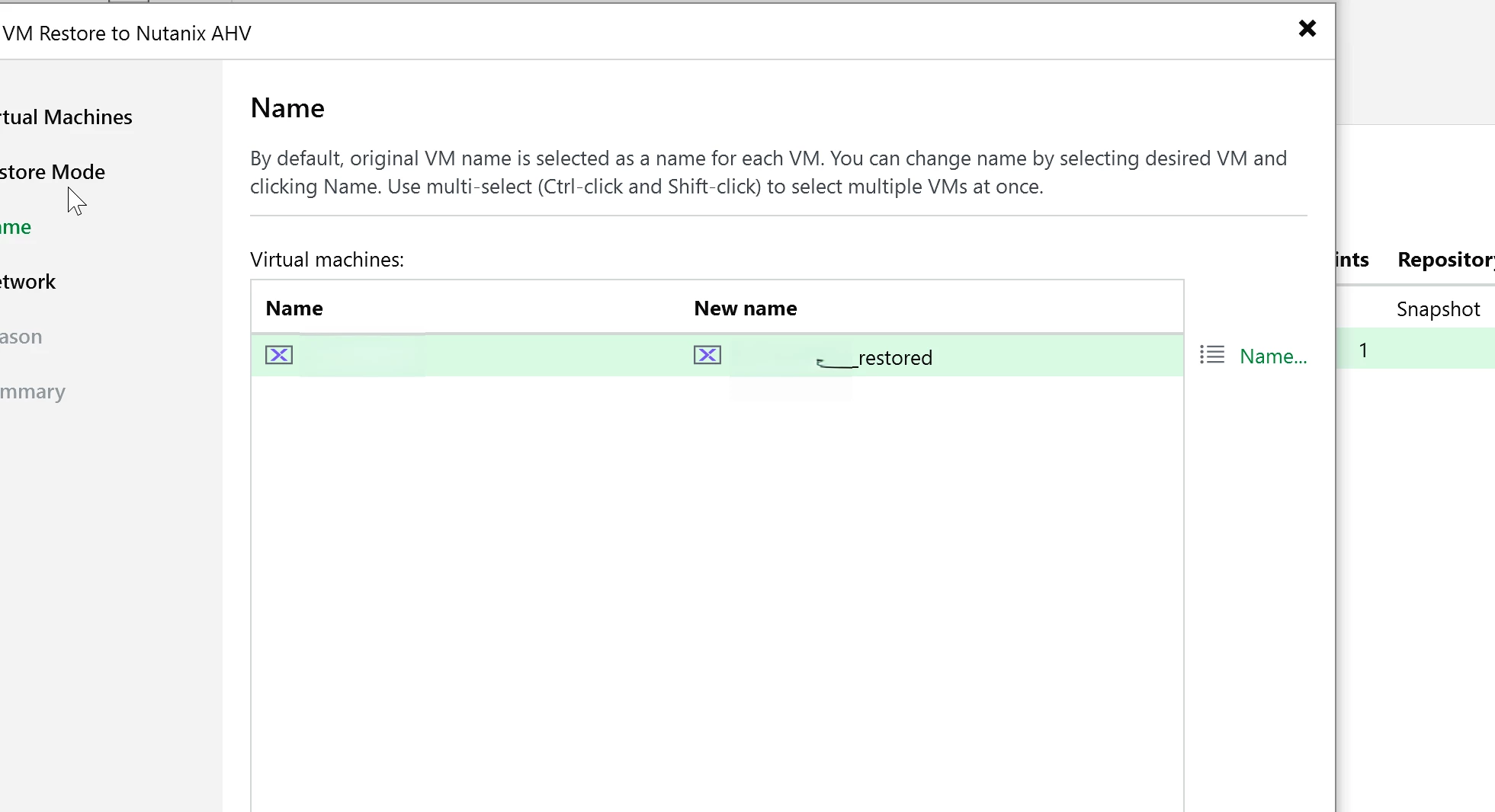

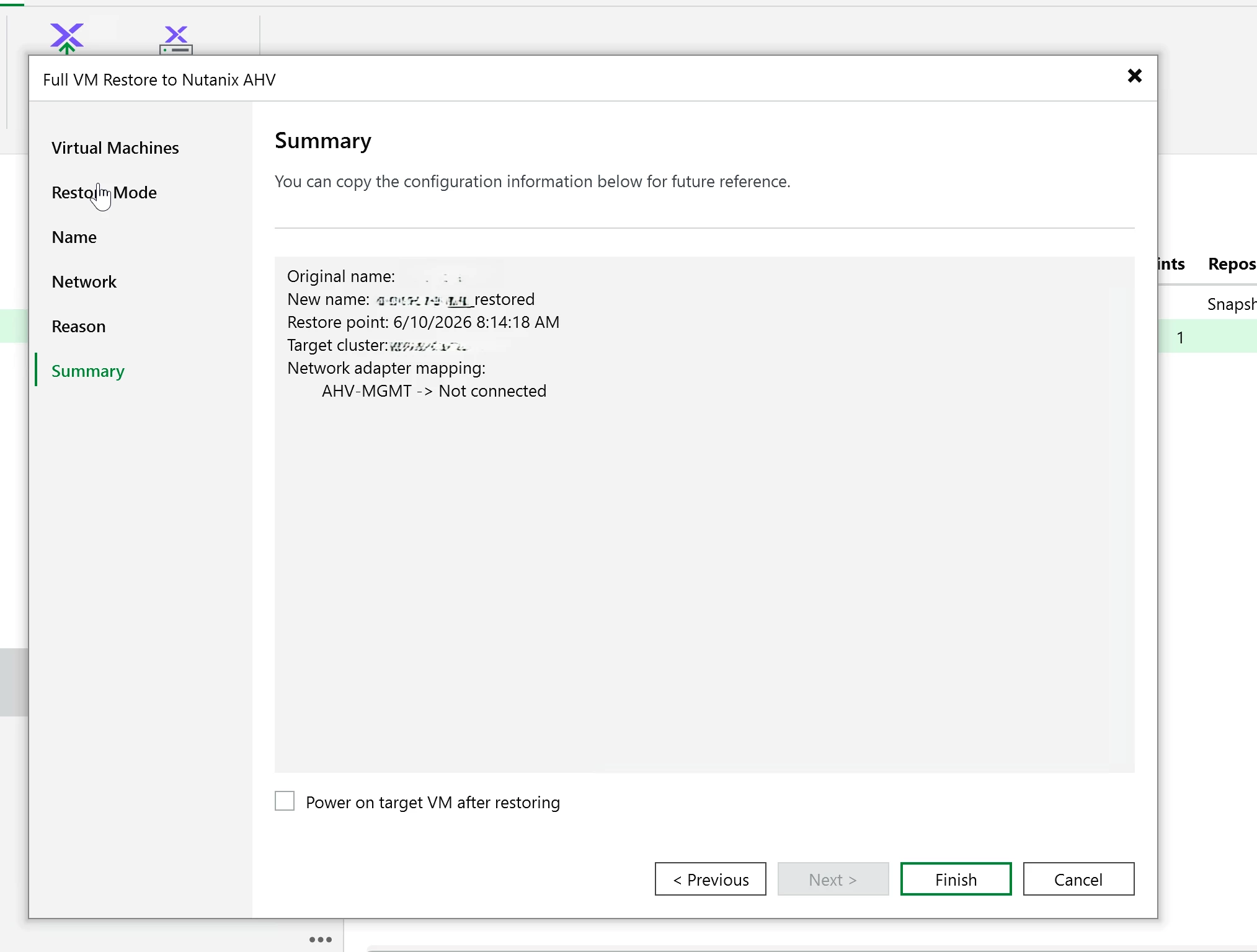

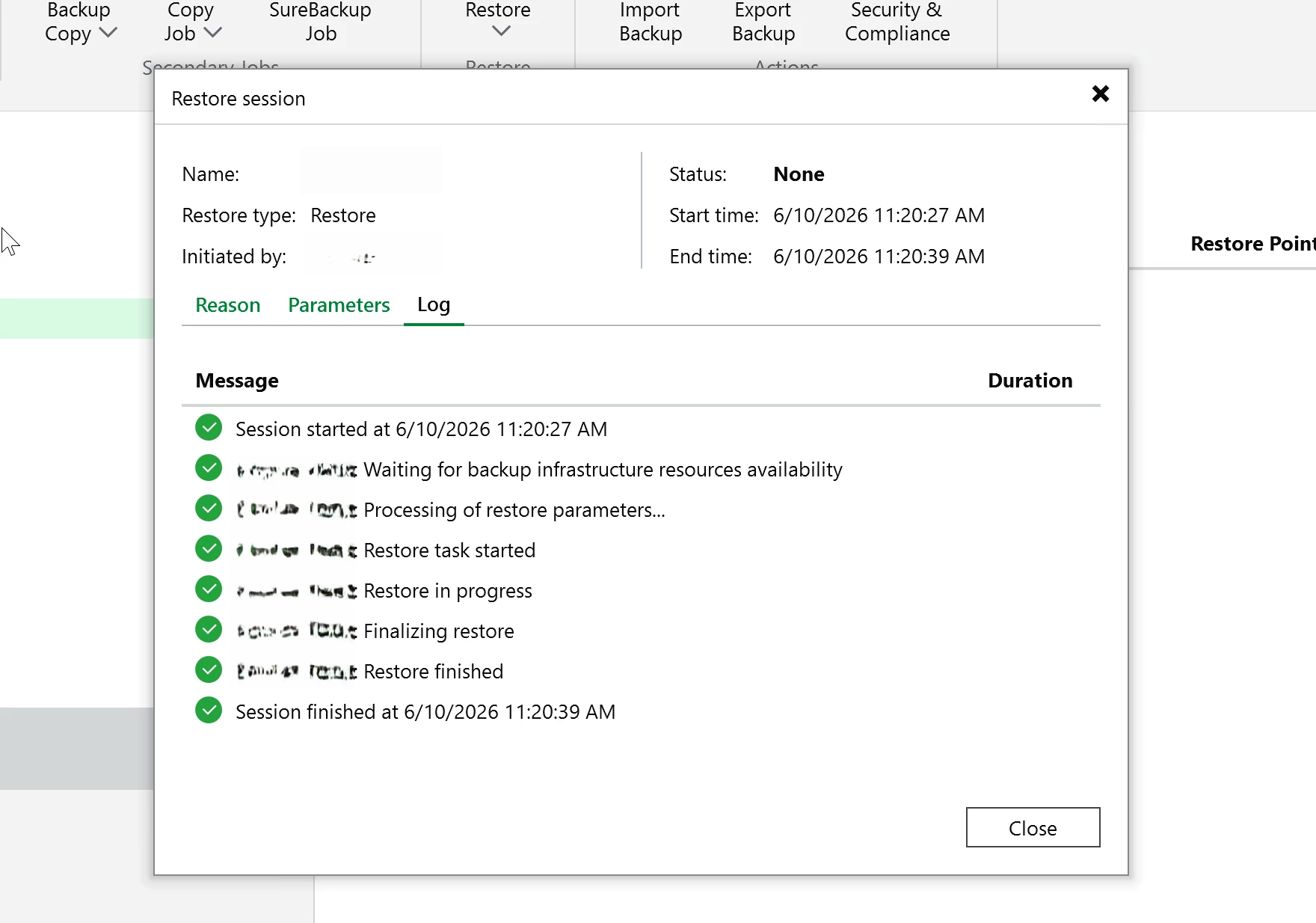

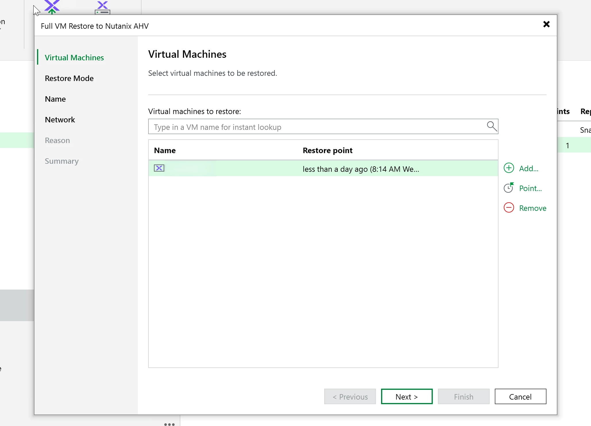

Performing a restore
I ran a restore after the backup. No point protecting something if you have not proven you can get it back right?
Go to backups in the VBR console. Right click the VM and select the restore type.
For this test, I used a full VM restore back to the same cluster. It completed cleanly and the VM came back online without issue. This cluster is on external storage (Pure NVME over IP.) It’s blazing fast with R/W.
