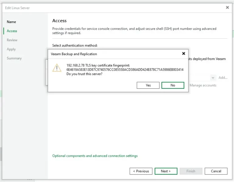

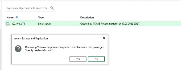

When we try to remove it, we are prompted with the error below. Removing Veeam components requires credentials with root privileges. Specify credentials now.
Also, because this (VM infrastructure) environment has been removed. You cannot also connect to it with any other root credential, as the transport service continues to run under the context of the veeamsvc (single-use credential). Here is a similar error discussed; perhaps these solutions might better suit you.
It will fail. Note that yu cannot use any other acocunt order than the veeamsvc for the single use credential.

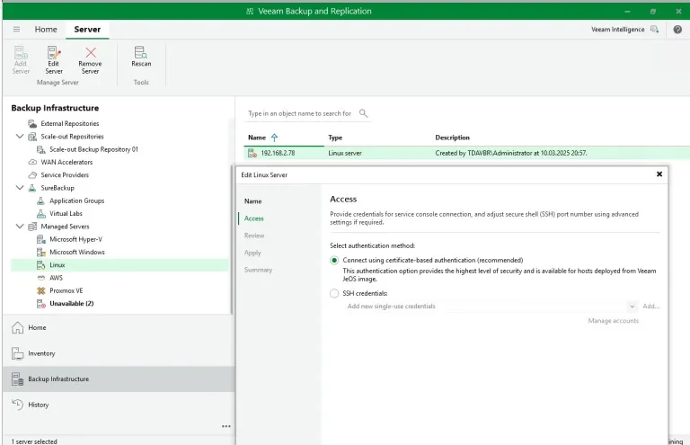

Remove the deleted VHR v2 from VBR
To remove the deleted VHR server from Veeam Backup & Replication (VBR) v13 managed servers after the job and repo are gone. Please, use PowerShell as shown below since the Web UI cannot be used in this case.
Kindly run the command on the VBR server. This unassigns the repo role only. The VHR server stays in managed servers if added separately; data on the Linux host remains untouched. But, this is not what I want as the server stays and repo vanishes which I have done before.
Get-VBRBackupRepository -Name "192.168.2.78" | Remove-VBRBackupRepository -Confirm:$false
To completely remove the VHR repo (“192.168.2.78”) from VBR v13. Unassigning it, and clearing all references, and handling the deleted host. Run the below PowerShell command.
Get-VBRServer -Name "VHR IP address or FQDN" | Remove-VBRServer -Confirm:$false
unassign role - check if deletion is possible and remove server
Ignore the final unreachable host warning that the server throws from the managed servers
server removed
Get-VBRBackupRepository | Where-Object {$_.Name -like "*192.168.2.78*"}
Get-VBRServer | Where-Object {$_.Name -like "*192.168.2.78*"}
verify clean
You can also use the commands below to confirm that the repo and server were correctly removed.
Get-VBRServer | ? Name -like "*192.168.2.78*"
clearned
