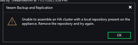

I have been working on a case with Veeam Support to do with HA Clustering and not being able to enable it due to this warning -
HA Cluster warning about local repository
It turns out somehow I tried to enable HA and then in one of my SOBRs added a capacity tier which was the cause of this.  The recommended solution -
  1. Remove the Capacity Tier (Wasabi in my case) from any SOBRs - I only had one in this case with a Capacity/Archive Tier.
  2. Enable HA Clustering which now works
  3. Add the Capacity Tier back to the SOBRs as needed
While not the most ideal solution it works.  I asked them to check KBs or Help pages to see if this is mentioned and if not get this added as a note or something so users are aware.  Lots of testing so it was good to find this one and get a solution.

A little crazy because the Wasabi repo isn't a local repository 🤔
But glad it worked for you, Chris
Chris.Childerhose
Forum|alt.badge.img+22
  • Author
  • Veeam Legend, Veeam Vanguard
  • November 26, 2025
Yeah it had something to do with creating a temporary local repo which HA does not like.  Once removed the HA function worked.
