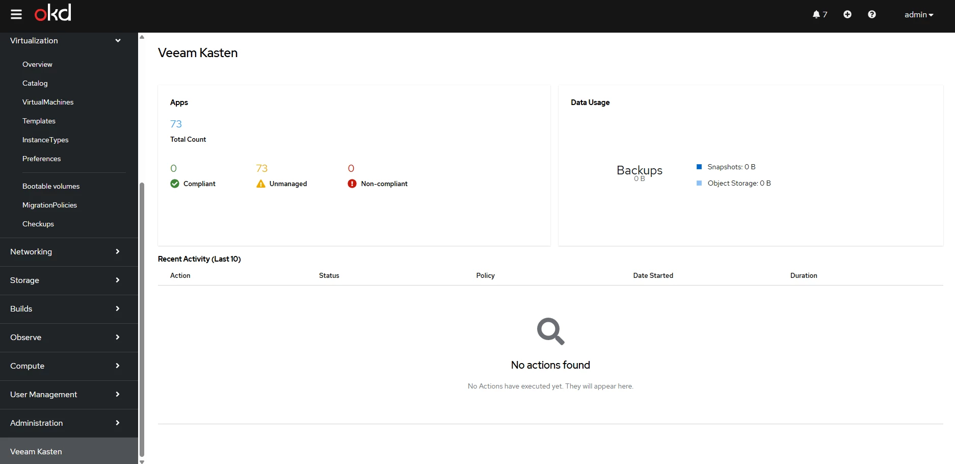

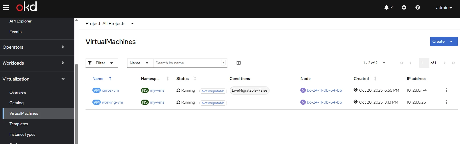

​@eprieto Thanks for this advice, this time it worked! Took a bit of tweaking, it did not like the storageclass name lvm-vg1 name (the Kasten operator at least) so I created an alias sc kasten-storage and boom working :) .
Even got some baby vms running with pvcs! Of course we will see the next steps, i.e. backing them up but so far so good!.
Thanks again!
