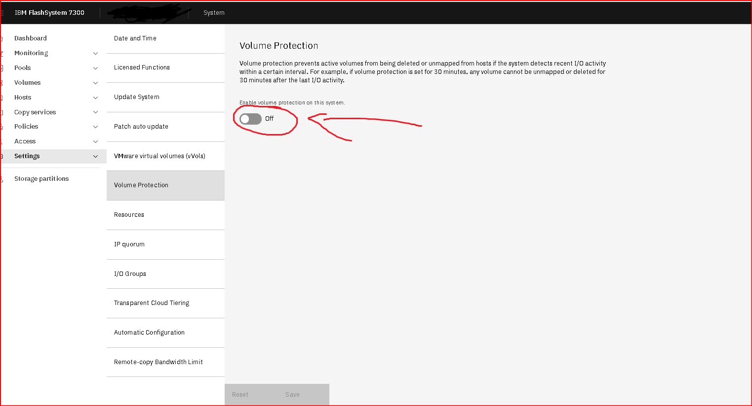

Hello,
We are having issues with the plugin. Something about Veeam not able to unmapp the volume, saying it has receive I/O within the defined volume protection period
Where we can see the actual commands Veeam is sending to the Storwize? You mentioned Audit log, but not there. Thank you.
What version of firmware are you on?
Do you have volume protection enabled?
If you are using volume protection, Veeam can’t delete the snapshot as there is I/O within the defined period.  You will want to ensure this is off.
