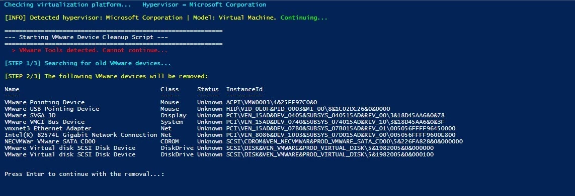

  • Safety Checks
    It first checks that it is not running on an active VMware hypervisor and will ask for confirmation twice if it detects one. It also checks for VMware Tools.
  • Pre-Scan
    The script scans for hidden VMware devices (like SVGA, VMCI, and PVSCSI) and old VMware driver packages in the Windows DriverStore.
  • Intelligent Execution
    If it finds no VMware components, it exits cleanly. It makes no changes and performs no unnecessary work.

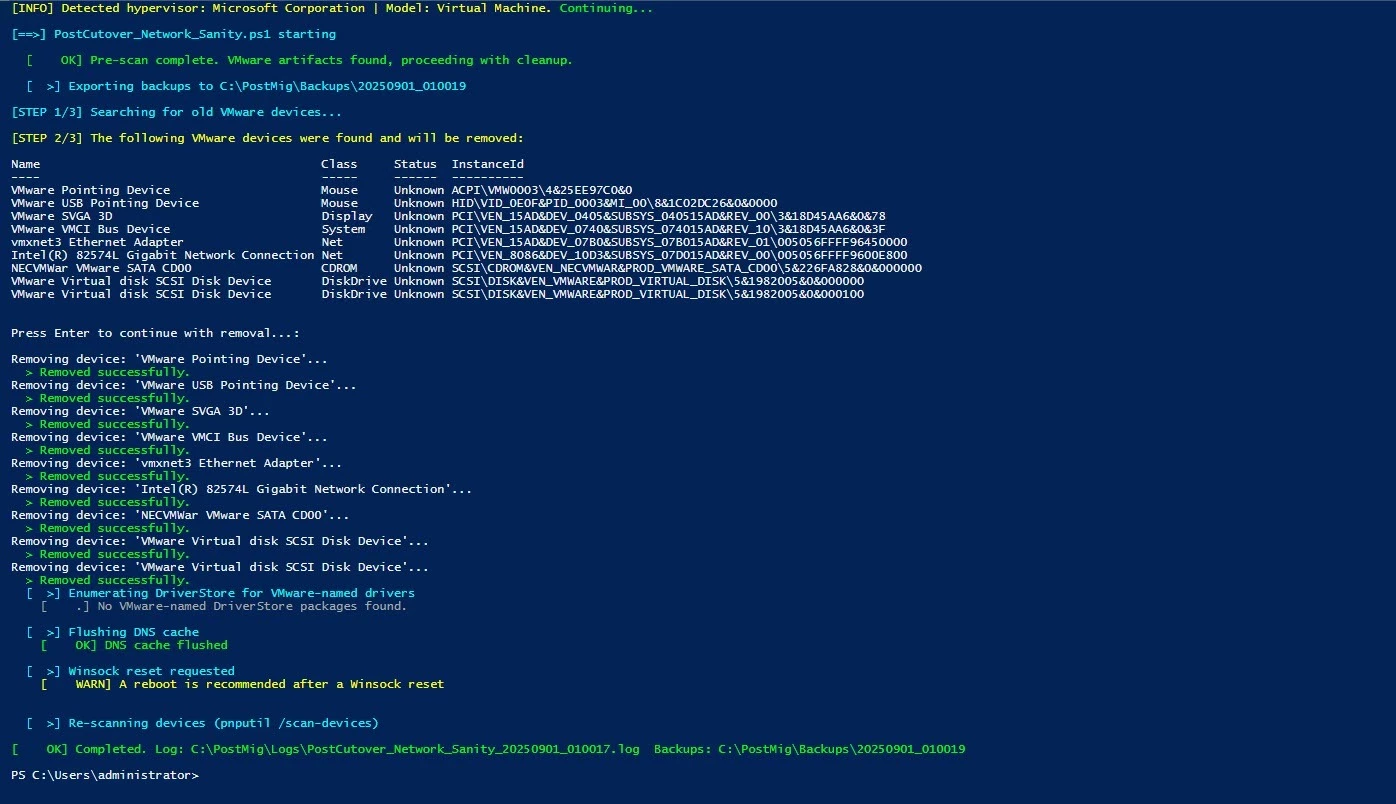

  • Automatic Backup
    If leftovers are found, it automatically backs up your current device inventory to C:\PostMig\Backups\. Every backup has a timestamp.
  • Automated Cleanup
    It then removes all hidden devices and cleans the Driver Store packages. By default, it also flushes the DNS and resets Winsock to clean the network state.
  • Logging
    Every action is recorded in a detailed log file stored in C:\PostMig\Logs\.

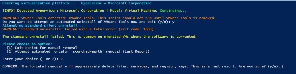

When VMware Tools Will Not Uninstall: The Last Resort
My number one rule is to uninstall VMware Tools before migrating. If you forget, the standard uninstaller will often fail with an error (1603). The script handles this:
  • It will first attempt the standard silent uninstall.
  • If that fails, it will present a menu with two choices:
    1. Exit: You can exit and try to remove it manually (for example, with the Microsoft Install/Uninstall Troubleshooter).
    2. Forceful Removal: You can authorize the script to perform a forceful removal, which deletes all VMware Tools services, files, drivers, and registry keys.
For situations where you need to perform this forceful removal as a standalone task, I have provided the Force-VMwareToolsRemove.ps1 script in the repository.

  • Remove All Hidden VMware Devices Only:
    .\PostCutover_Network_Sanity.ps1 -CleanupDevices

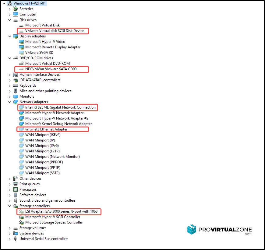

Verify Your Success
After the script finishes, confirm that everything is clean:
  • Open Device Manager and select "View" > "Show hidden devices." The VMware devices should be gone.
  • Run pnputil /enum-drivers in PowerShell or CMD. Confirm that packages for vmxnet, pvscsi, vmci, and others are no longer listed.
  • Check ipconfig /all. Your IP address, gateway, and DNS servers should be exactly as they were before.
  • Review the log file in C:\PostMig\Logs\ for a final confirmation.

Hi ​@JailBreak,
thanks for this fantastic info.
I was only wondering where are the linux scripts in the Github? It only contains a readme file :(
I know everyone is expecting the Linux scripts, even receive emails and github requests. But I have been so busy lately that this is not my priority. When I have time I will do this.
The ones I have are very customer customize, so I can share those. I need to have time to change it to a more general project and remove any customer information.
JailBreak
Forum|alt.badge.img+3
  • Author
  • Experienced User
  • Feb 22, 2026 6:56 PM UTC
Hi ​@JailBreak ,
These are some really valuable resources as our company plans to migrate from VMware to Hyper-V using VEEAM. I’m wondering if I’m right about the recommended IVMR workflow:
- Full backup VM
- Run Pre-Migration Script
- Power Off VM (prevent changes)
- Initiate IVMR
- Migrate to Production
- Snapshot VM post-migration
- Run Post-Migration Script
- Validate VM and hosted applications
I checked your GitHub and can’t find the Pre-Migration script you mentioned in some other responses only the Post-Migration script. You mentioned you have some tools you can’t share publicly. Is the Pre-Migration script one of them? Would these scripts and tools be available to VEEAM customers?
I have updated the pre, post and remove hidden files scripts. So now only the new improved versions are there. The old scripts were removed to avoid confusion. You can now use the pre and post migration scripts from the GitHub repo.
Your workflow looks correct, but just a small note — if you are using Veeam IVMR to migrate to Hyper-V, removing VMware Tools before the migration is only necessary if you had issues removing them after. In most cases you can remove VMware Tools after the migration on the Hyper-V side. If you want to skip that step, just comment out the VMware Tools section in the pre-migration script and it will not be removed before the migration.
Also, if you need to run the pre-migration script on multiple VMs at once, I have added a GPO edition of the script in the "GPO Scripts" folder. This is an unattended version that you can deploy via Group Policy to an AD Organizational Unit. It runs silently with no user prompts — everything is controlled via parameters. There is a full step-by-step deployment guide included in the folder.
As always, please make sure to test all scripts in a non-production environment first before running them on any production or critical infrastructure. Every environment is different, and testing ensures the scripts work correctly in your specific setup.
Hope this helps with your migration project!
