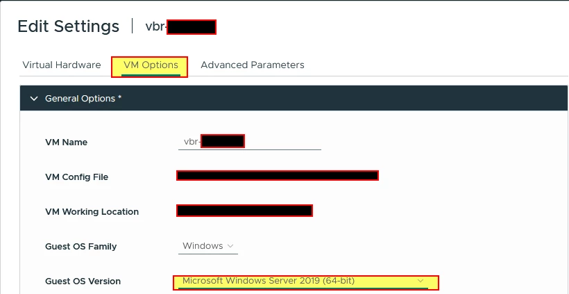

Preparing the VM (VMware side)
Before enabling EFI BIOS, you must convert the MBR boot partition to GPT.
Before activating the settings in Windows, you must modify the virtual machine configuration.

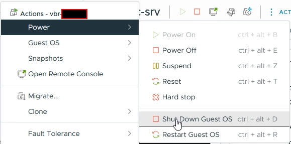

1.    Shut down the VM (this cannot be done while it is running).
2.    Right-click on the VM > Edit Settings.
3. Go to the VM Options tab.
4. Expand the General Options section and ensure that the Guest OS is set to Windows Server 2016 or higher (or Windows 10/11).

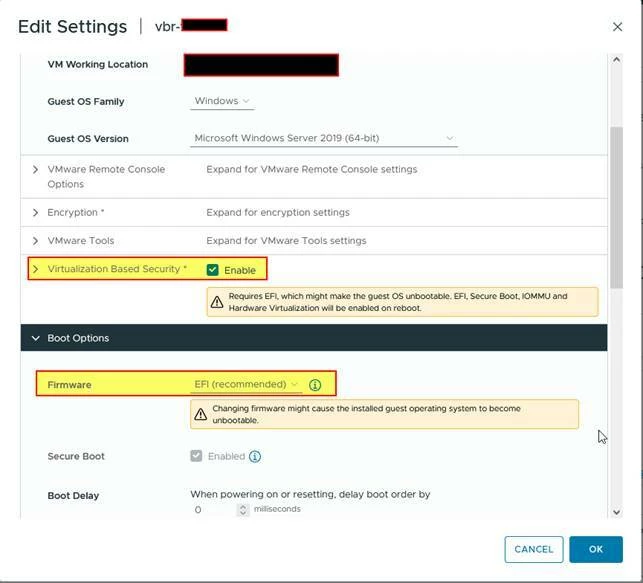

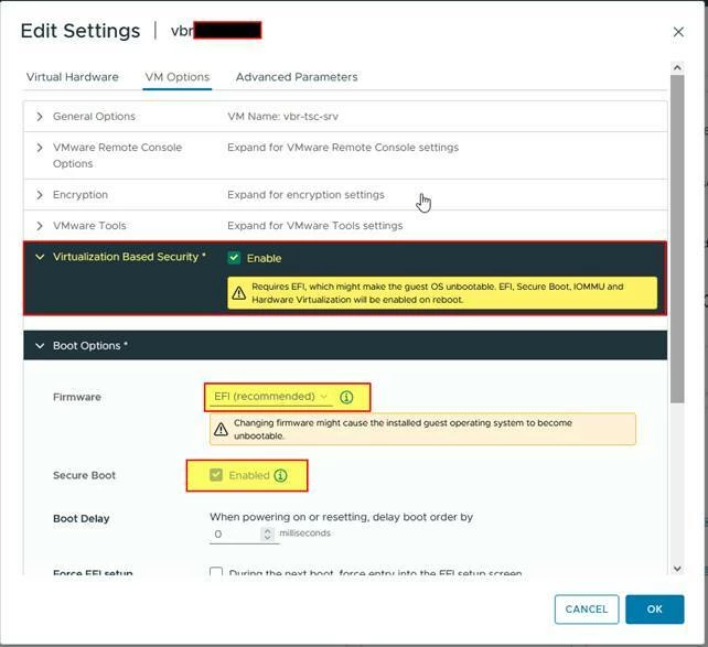

5. Expand the Boot Options section and verify that the Firmware is set to UEFI and that the Secure Boot box is checked.
6. Expand VBS (Virtualisation Based Security) and check the Enable box.
Note: This will automatically enable the IOMMU extension and hardware virtualisation exposed to the guest.

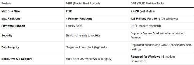

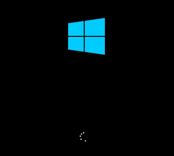

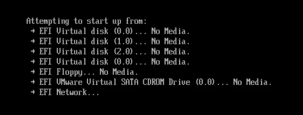

If the VM no longer boots, it is the classic EFI boot “black screen”. What you are seeing is because your Windows server was originally installed using the old BIOS (Legacy) system.
When you changed the setting to UEFI in the VMware options, the virtual machine stopped finding the boot sector on the disk, because BIOS disks use the MBR scheme, while UEFI looks for the GPT scheme.
1) Roll back the VMware vHW configuration.
If you need to restart Veeam urgently, shut down the VM and reset the firmware to Legacy (BIOS).
 The server will restart immediately.
Cons: You will not be able to enable Credential Guard, because it is a fundamental requirement that the system runs in UEFI mode.

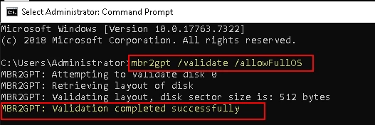

Run this command to validate the disk (assuming that disk C: is disk 0):
 mbr2gpt /validate /allowFullOS
mbr2gpt /validate /disk:0 /allowFullOS

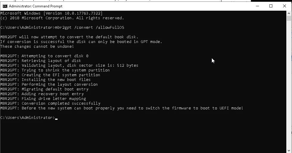

If the response is ‘Validation completed successfully’, proceed with the conversion:
mbr2gpt /convert /allowFullOS
Once successfully completed, shut down the VM.
Now change the firmware to UEFI (and enable Secure Boot) in the VMware settings.
Restart the VM: Windows will now load correctly in UEFI mode.

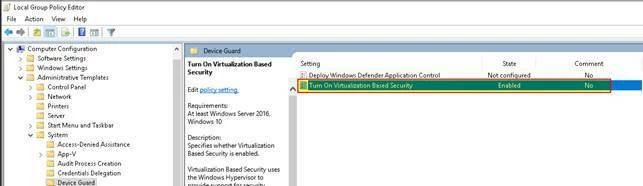

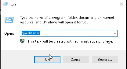

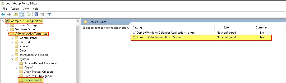

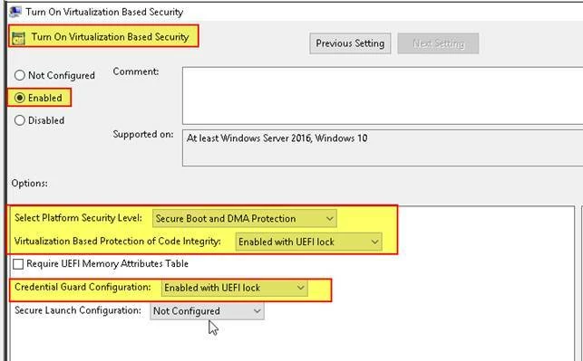

Configure Credential guard om Local Group Policy
Virtualization Based Protection of Code Integrity
This setting enables virtualization based protection of Kernel Mode Code Integrity. When this is enabled, kernel mode memory protections are enforced and the Code Integrity validation path is protected by the Virtualization Based Security feature.
The "Disabled" option turns off Virtualization Based Protection of Code Integrity remotely if it was previously turned on with the "Enabled without lock" option
The "Enabled with UEFI lock" option ensures that Virtualization Based Protection of Code Integrity cannot be disabled remotely. In order to disable the feature, you must set the Group Policy to "Disabled" as well as remove the security functionality from each computer, with a physically present user, in order to clear configuration persisted in UEFI.
The "Enabled without lock" option allows Virtualization Based Protection of Code Integrity to be disabled remotely by using Group Policy.
Credential Guard
This setting lets users turn on Credential Guard with virtualization-based security to help protect credentials.
The "Disabled" option turns off Credential Guard remotely if it was previously turned on with the "Enabled without lock" option.
The "Enabled with UEFI lock" option ensures that Credential Guard cannot be disabled remotely. In order to disable the feature, you must set the Group Policy to "Disabled" as well as remove the security functionality from each computer, with a physically present user, in order to clear configuration persisted in UEFI.
The "Enabled without lock" option allows Credential Guard to be disabled remotely by using Group Policy. The devices that use this setting must be running at least Windows 10 (Version 1511).

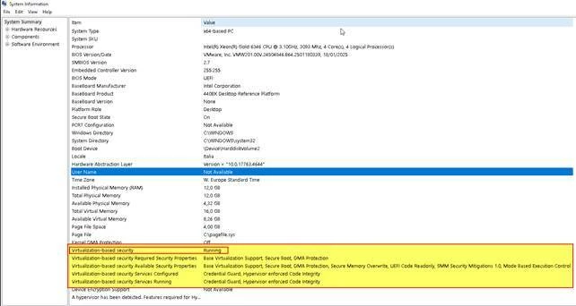

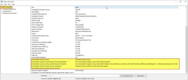

Check
run executable
msinfo32.exe
Reboot server
Check
