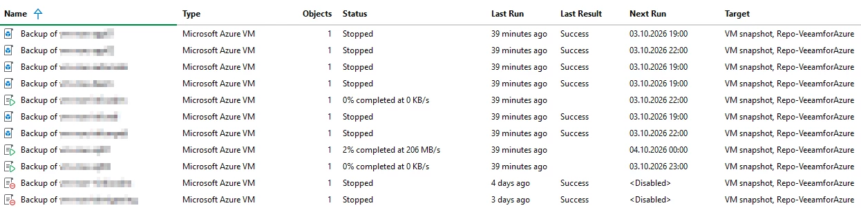

Each VM received its own backup job.
This made it easy to identify:
  • Which VMs had been backed up
  • Which VMs were ready for migration
  • Which VMs had already been migrated
  • Which workloads were still running in Azure
It also provided clear control over the migration process.

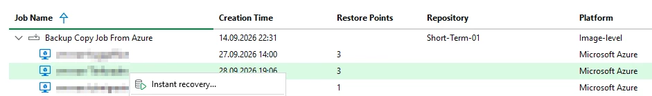

Creating the Local Backup Copy
Before migrating a VM, we used a Veeam Backup Copy job to transfer the backup data from Azure to the local Veeam repository.
This turned out to be an important part of the migration design.
Although it was technically possible to perform Instant Recovery directly from the Azure repository, the available Internet connection made this considerably slower.
By transferring the backup to the local repository first, we could perform the recovery locally at significantly higher speed.

  1. The VM continued running in Azure.
  2. Veeam maintained the backup.
  3. The latest backup was copied to the local Veeam repository.
  4. We stopped the VM in Azure.
  5. We manually started a final backup.
  6. The final backup captured the latest changes.
  7. The backup was synchronized to the local repository.
  8. We performed Instant Recovery to the on-premises Hyper-V environment.
The final manual backup was important.
By stopping the Azure VM before starting the final backup, we could ensure that no application changes were made after the final backup began.
This minimized the risk of data loss between the last scheduled backup and the migration.

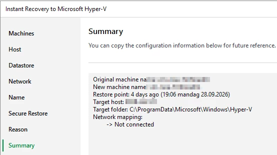

Instant Recovery to Hyper-V
Once the backup was available in the local repository, we used Veeam Instant Recovery to start the VM directly from the backup.
During the recovery process we selected:
  • Hyper-V host
  • Target datastore
  • Target network
The VM was then started in the new environment.

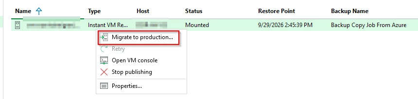

Moving the VM into Production
Once the VM had successfully booted and the application had been tested, we used Veeam to migrate the VM into its final production location.
This leveraged the Hyper-V storage migration functionality.
The process moved the VM from the temporary Instant Recovery location to the production datastore and cleaned up the temporary recovery environment.
From the application's perspective, the transition was relatively simple.
The VM was now running on the new infrastructure, but because it had moved from Azure to a different network, it initially had the wrong IP configuration.
We opened the VM console and configured:
  • IP address
  • Default gateway
  • DNS servers
The DNS records were updated and the application was back online within minutes.

Having a local copy of the Azure backups made a major difference.
It allowed us to recover workloads at local network speeds instead of relying entirely on the Internet connection to Azure.
4. Backup can also become a migration tool
Veeam was not only our backup platform.
It became an important part of the migration strategy itself.
The ability to take a backup, move that backup to the target environment and perform Instant Recovery gave us a flexible migration path without requiring specialized migration tooling.
