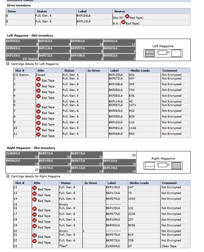

One of the scenarios that pushed me deeper into advanced tape troubleshooting involved an LTO environment where multiple tapes suddenly started being marked as bad inside Veeam.
At first, this looked like a typical media degradation case.
But after analyzing the environment more carefully, some behaviors stopped making sense.
Tapes with very low load counts were failing.
Different media presented identical symptoms.
And eventually, nearly every tape inserted into the drives was immediately retired after write attempts.
At that point, the objective was no longer simply identifying failed media.
The real challenge became understanding whether the failures were actually coming from the tapes, the drives, or even the library itself.
That was the moment when troubleshooting needed to move beyond the backup application and into deeper hardware-level diagnostics.

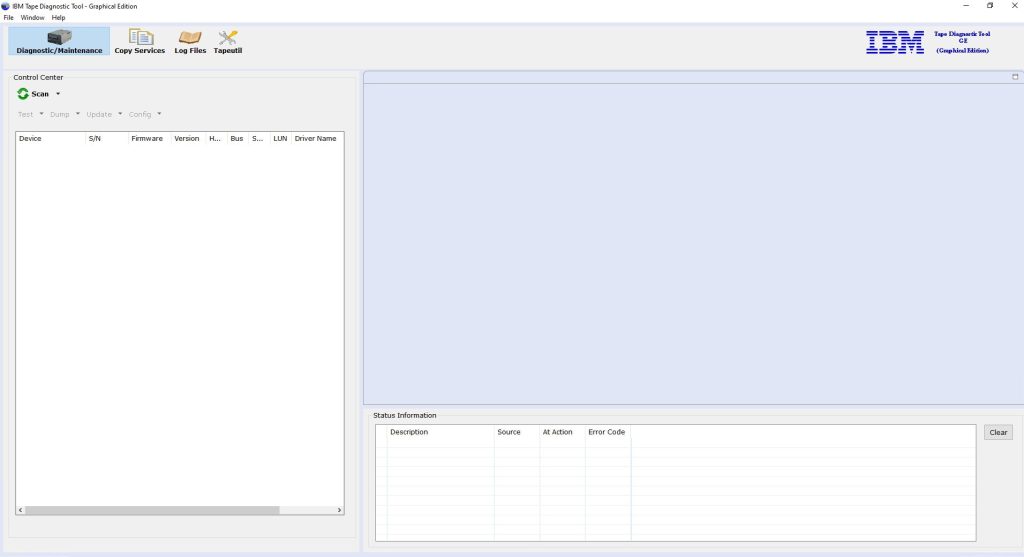

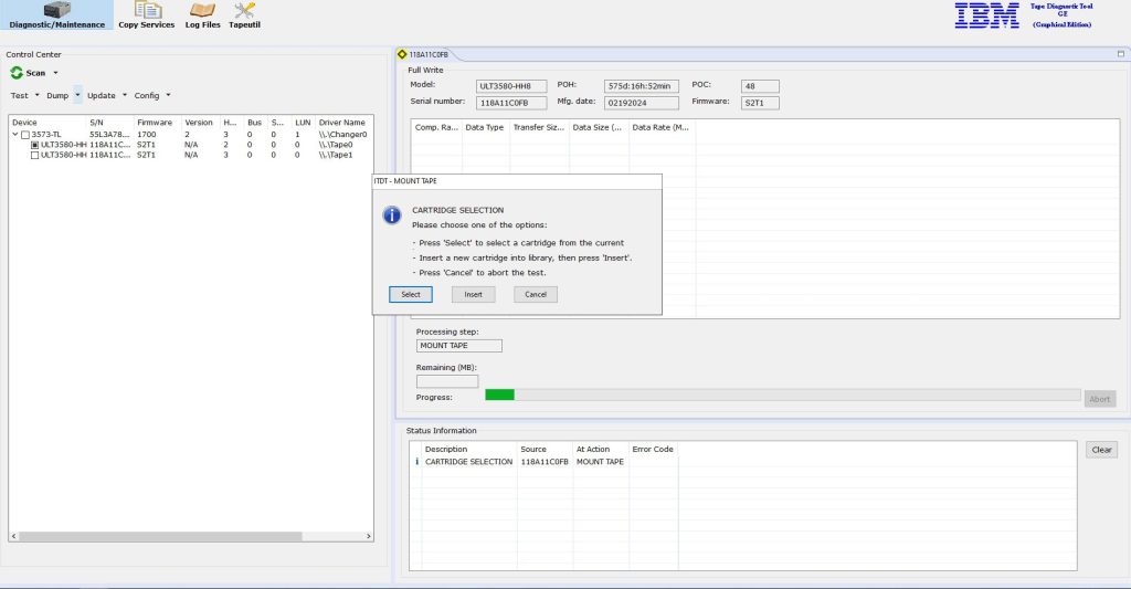

Starting the ITDT Analysis

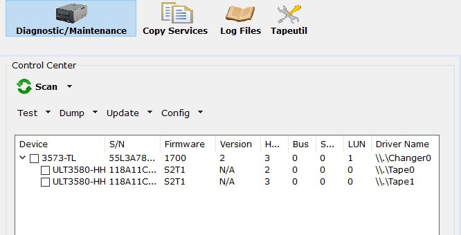

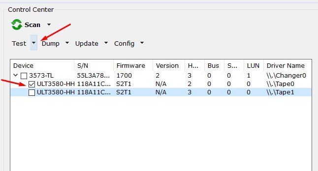

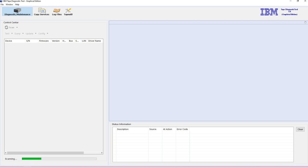

The first step was running a scan to identify the available tape devices connected to the server.
Itdt Gui
Scan Library
Scanning Progress
This already helps validate important points such as:
  • Drive visibility
  • Device communication
  • Operating system detection
  • Drive path availability

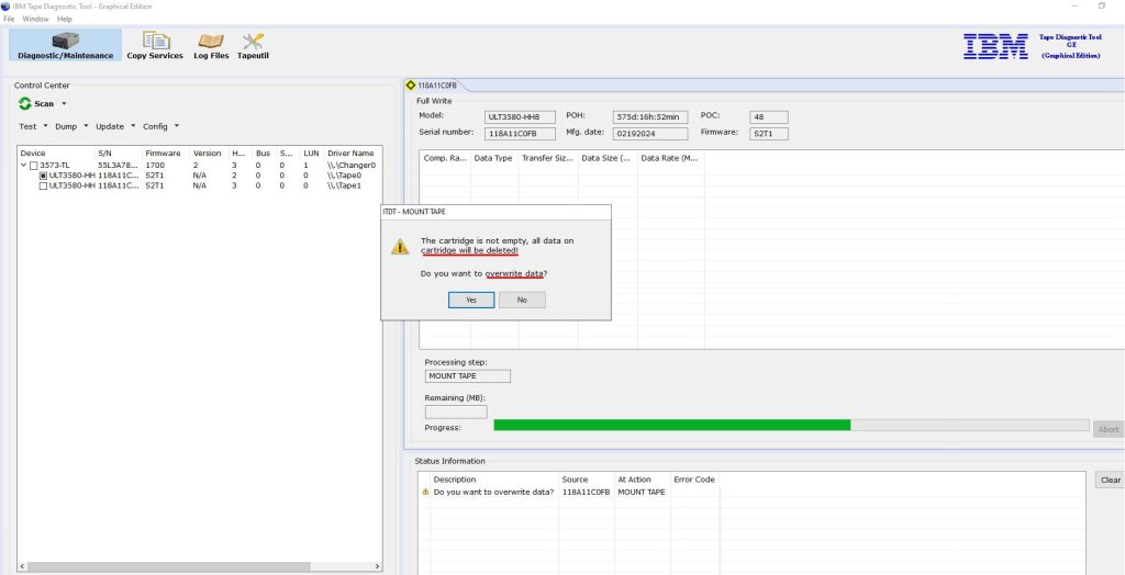

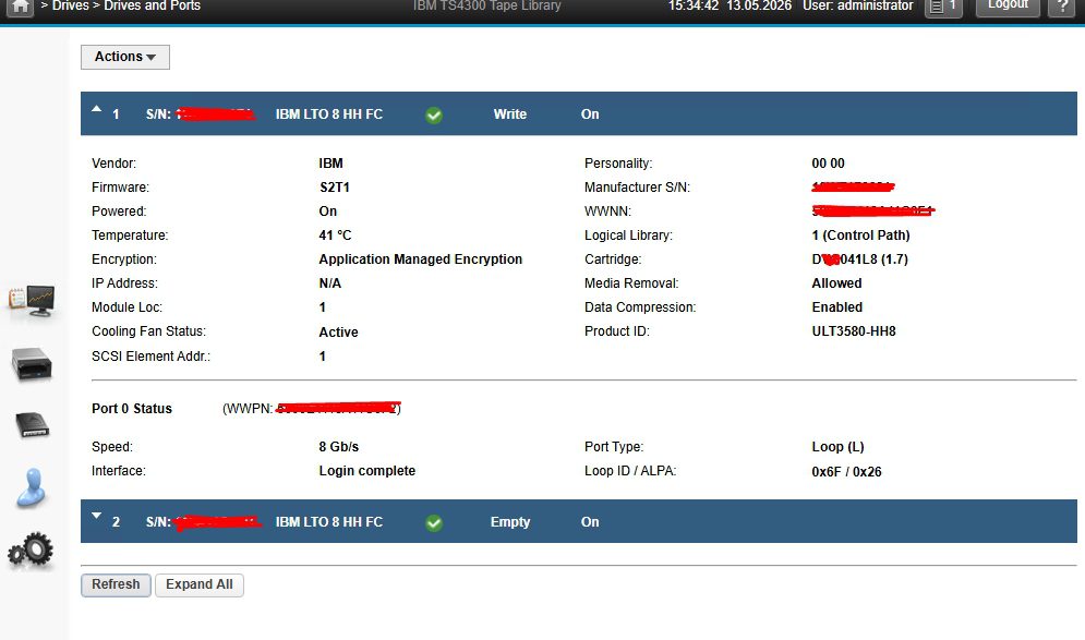

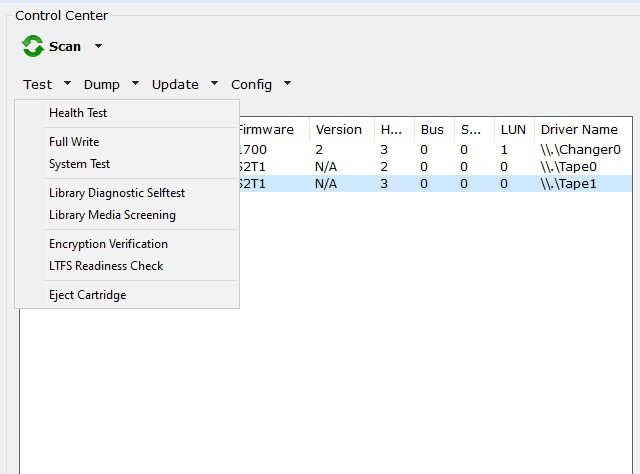

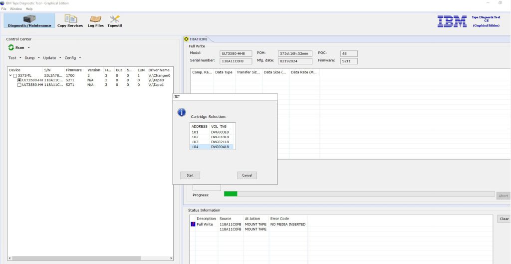

After identifying the drives, I started the Full Write Test.
Devices
One detail I found important during this process was media selection.
For the test, I intentionally used a tape that was not blank, but also not actively being used by Veeam.
The tape was already located inside the Free media pool, ensuring no active backup chain would be impacted during testing.
This is an important operational consideration during tape diagnostics.
Depending on the library configuration and the amount of media available inside the I/O slot, ITDT also allows selecting which tape should be used during the test.
That flexibility helps avoid accidental use of production media.
Select Device 1
All Testes
Full Write Teste
Selecting Tape

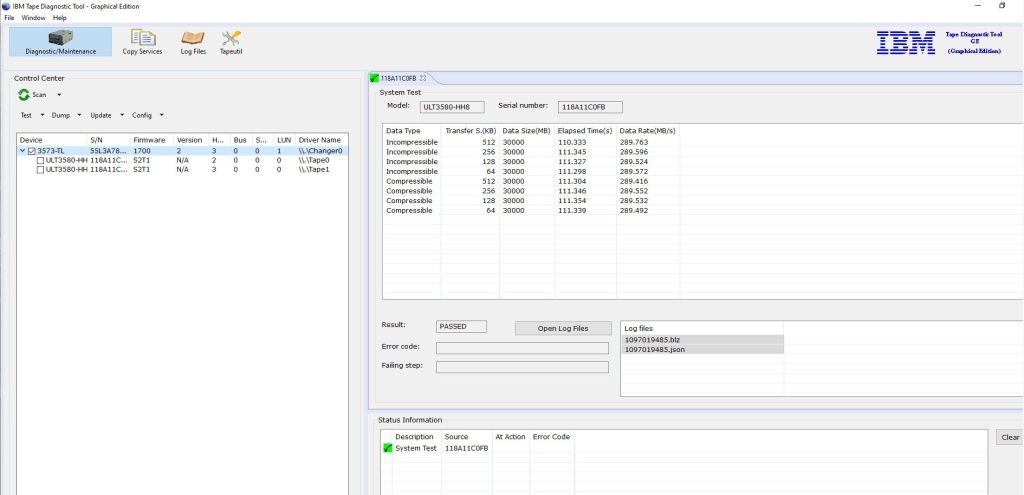

Understanding the Full Write Test

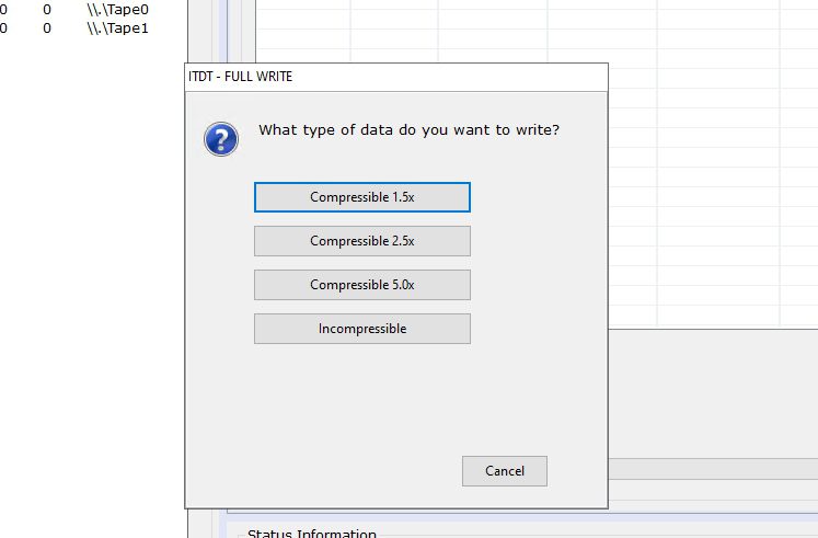

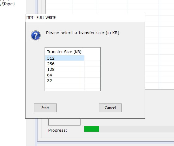

During the Full Write Test, ITDT requests some parameters before starting the operation.
Some of the most interesting ones are:
  • Compression ratio
  • Transfer size
Transfer Size
Compression
Tape Used
At first glance, these options may look simple, but they directly affect how the test behaves.
Different transfer sizes can impact throughput and execution time, while compression settings can simulate write patterns closer to real backup workloads.
Another important point is execution time.
These tests are not quick.
Depending on the tape size, drive generation, and selected parameters, the process can take a considerable amount of time to complete.
And that is actually a good thing.
Because many tape drive errors only appear under sustained write operations.
That was exactly what happened in this environment.
Teste Running 1

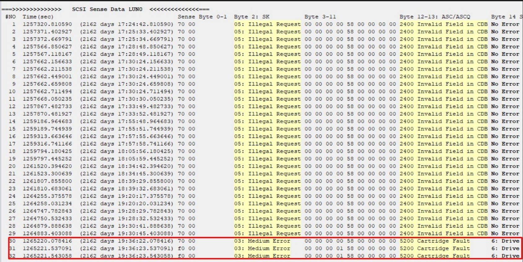

The Real Problem Appears

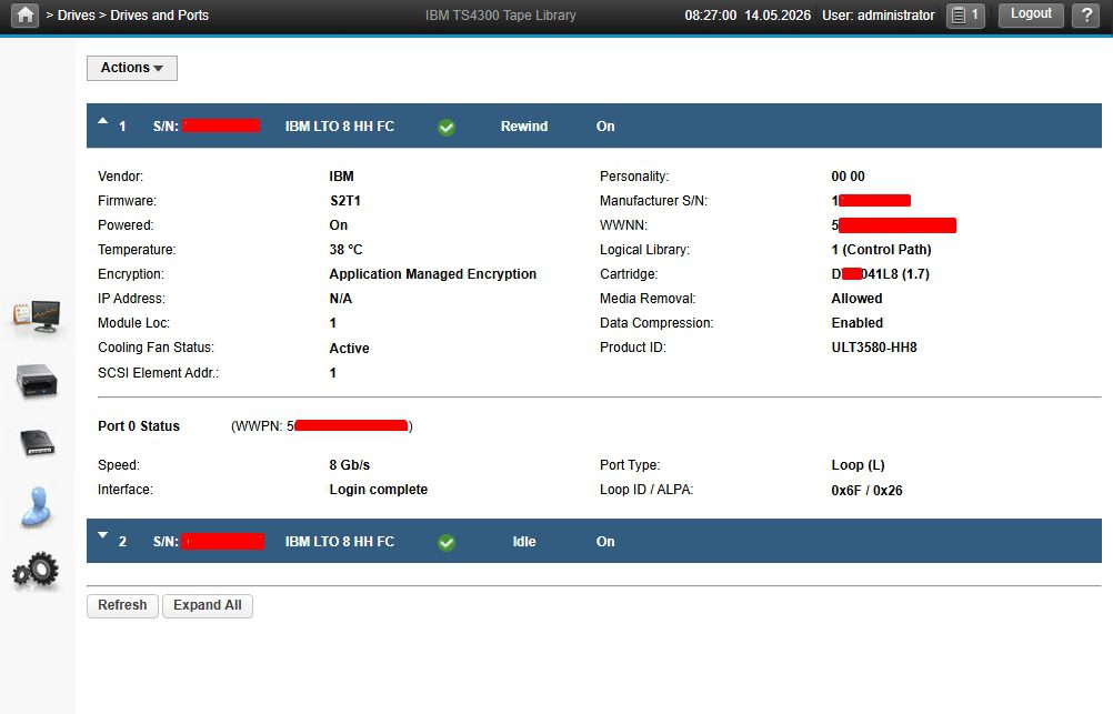

During basic validations, the environment appeared relatively normal.
But under full write load, the drives started failing consistently.
That completely changed the direction of the investigation.
The issue was not the media.
The issue was the drives themselves.
Both drives presented failures during write operations, independent of which tape was inserted.
Without deeper LTO diagnostics using ITDT, the most likely outcome would have been unnecessary media replacement.
Itdt Test 2
Cartrige Fault

Another interesting part of the process was running robotics-related diagnostics.
This is something frequently overlooked during tape troubleshooting.
Many administrators focus only on media or drives, but robotics failures can also generate symptoms that look like tape media issues.
Testing the robotics system helps validate:
  • Media movement
  • Slot communication
  • Load and unload operations
  • Mechanical consistency
This helps identify whether the issue is isolated to the drives or if the tape library itself is also involved.

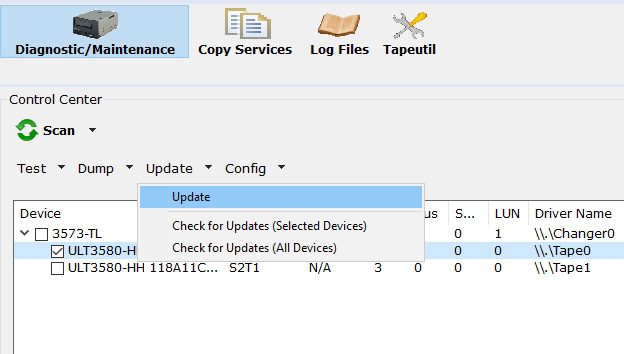

Firmware Validation and Microcode Analysis
Another useful capability provided by ITDT is firmware visibility and microcode management.
During tape troubleshooting, validating firmware versions can be just as important as validating media health or drive behavior.
In some environments, especially older tape infrastructures, firmware inconsistencies between drives, robotics, HBAs, and libraries can generate unstable or difficult-to-identify behavior.
ITDT helps provide visibility into the current firmware running on the drives and can also assist during firmware upgrade or downgrade procedures when necessary.
That said, firmware changes should always be performed carefully and ideally aligned with vendor recommendations and compatibility matrices.
In some situations, updating firmware may resolve stability issues, while in others, introducing unsupported combinations can create additional problems.
Because of that, firmware operations should always be treated as controlled maintenance procedures rather than generic troubleshooting attempts.
These tools do not replace vendor support.
Firmware Update

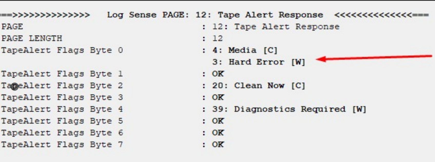

One interesting aspect of Tapeutil is how closely it interacts with the tape device itself.
Instead of simply reporting generic backup failures, it allows direct access to SCSI-level operations and device responses, which can be extremely valuable during complex tape drive errors or inconsistent media behavior investigations.
In some scenarios, collecting Request Sense and Log Sense information can provide significantly more visibility into what is actually happening at the hardware level.
This becomes especially valuable when:
  • validating intermittent failures
  • analyzing hardware instability
  • identifying firmware-related behavior
  • or gathering deeper evidence before escalation

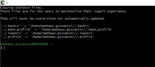

In another scenario, I worked with tapes that had already been marked as BAD inside Veeam, even though they showed healthy usage characteristics.
Cwin Terminal
Low load counts.
No obvious signs of degradation.
No clear indication that the media was physically damaged.
That’s where direct tape device interaction became useful.

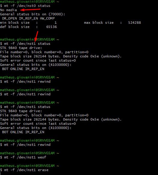

Although this environment was running on Windows, Cygwin was used to provide access to Unix-style tape utilities and low-level command interaction.
Using commands like:
mt -f /dev/nst0 status
mt -f /dev/nst0 rewind
mt -f /dev/nst0 weof
mt -f /dev/nst0 erase
allowed direct interaction with the tape device outside of the backup application.
The dev/nst0 path represents the first non-rewinding tape device detected by the operating system. In environments with multiple tape drives, additional devices may appear as dev/nst1, dev/nst2 and so on.
Identifying the correct tape device before executing low-level operations is extremely important, especially in environments with multiple drives connected to the same tape library.
Before executing these commands, the tape must already be loaded into the corresponding drive. These operations interact directly with the tape device itself, not with the library slots.
In practical terms, this means the media needs to be loaded into the correct drive before running commands against the device path.
Non-rewinding devices (nst) are commonly used during backup operations because they preserve tape position between commands instead of automatically rewinding the media after each operation.
Tape On Drive 1
Rewind Process
Weof Command
Tape Erase
Why Low-Level Tape Commands Matter in Tape Troubleshooting
One important limitation in many tape environments is that not every operation is exposed through the backup application or through the tape library GUI itself.
Commands like these provide additional flexibility for:
  • Checking device status
  • Rewinding media
  • Writing EOF markers
  • Erasing tapes completely
  • Validating tape behavior outside of Veeam
In some scenarios, this helps determine whether a tape marked as bad is truly unusable or simply in a logically inconsistent state.
In most scenarios, I usually start by validating the current tape device status before performing any operation.
This helps confirm whether the tape is correctly loaded and whether the operating system is communicating properly with the drive.
If the tape position appears inconsistent, rewinding the media is typically the next step.
Depending on the operating system and tape workflow being used, writing EOF markers may also be useful during specific low-level validation procedures.
And finally, when deeper validation is required or the media needs to be fully reset, an erase operation may be performed.
Because these commands operate directly at the tape device level, they should always be executed carefully to avoid unintended data loss or backup chain impact.

Using Cygwin for Low-Level Tape Interaction
Cygwin provides access to Unix-style utilities and command-line interaction inside Windows environments.
I do not use these tools daily, and I do not consider myself an expert in every low-level tape operation available through them.
But in specific troubleshooting scenarios, they become extremely useful precisely because they offer capabilities that are not available directly through Veeam or through the tape library interface.
In my case, I mainly used them during validation scenarios involving tapes previously marked as bad.
The objective was not to bypass Veeam behavior, but to better understand whether the media was truly compromised or simply required deeper validation.
That distinction matters.
Especially in environments where unnecessary tape replacement can become expensive very quickly.

That is where tools like ITDT, Tapeutil, Cygwin, and tape device commands become valuable.
Not as replacements for vendor support.
But as additional layers of visibility during the troubleshooting process.

The same symptom can point to multiple root causes.
What initially looks like bad media can actually be:
  • failing drives
  • unstable robotics
  • firmware issues
  • logical inconsistencies
  • or hardware instability under load
That is why advanced tape troubleshooting matters.
Tools like ITDT, Tapeutil, Cygwin, and low-level tape commands provide visibility beyond what traditional backup interfaces expose.
And sometimes, that visibility is exactly what helps identify the real problem.
