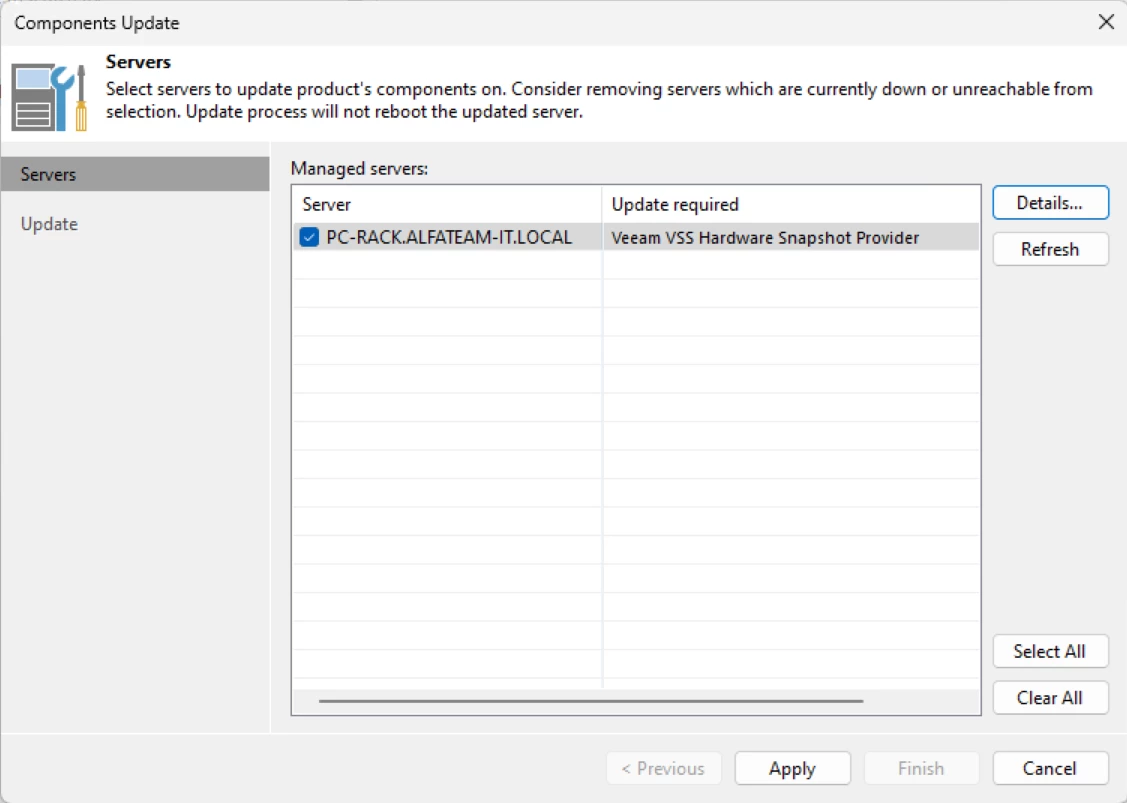

Hi,
I have upgraded Veeam backup and Replication from V12.0 to V12.2.
When I logon to console it ask me to upgrade Veeam VSS Hardware snapshot provider.

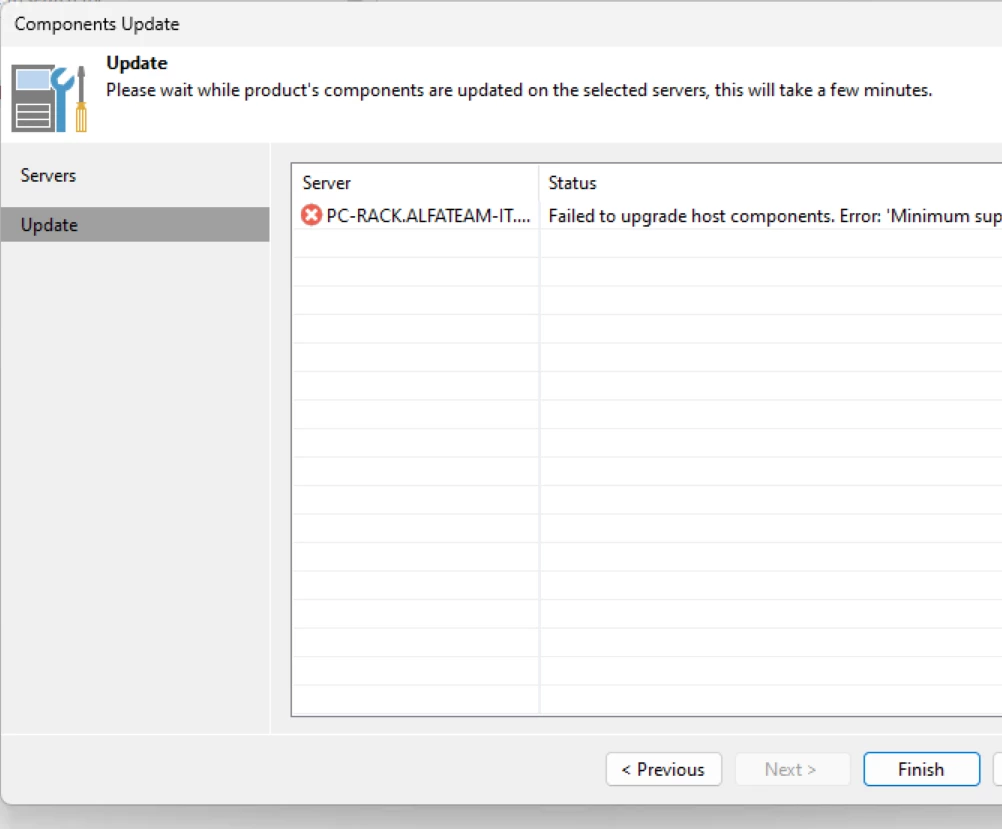

If I try to upgreade it give me this error:
Product: Veeam VSS Hardware Provider -- Minimum supported OS version for Veeam VSS Hardware Provider is Microsoft Server 2012 (64-bit only).
How can I resolve this issue?
thanks
Fabio

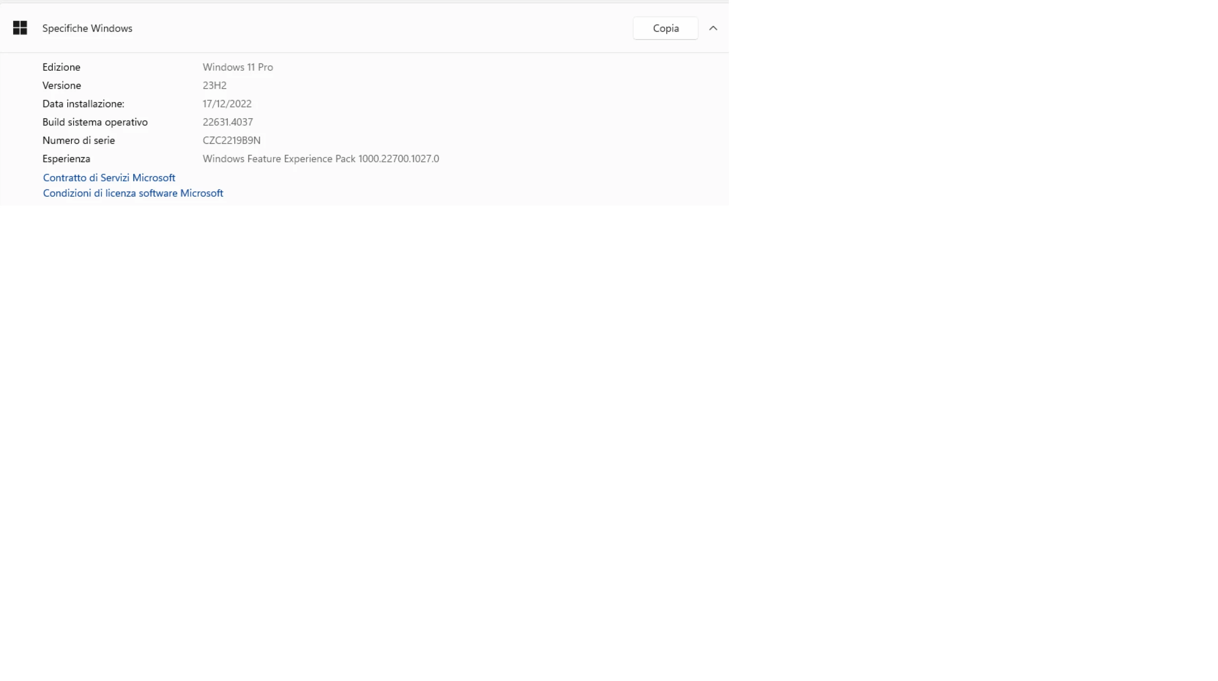

Hi Chris,
the message is not clear because OS is Windows 11 23H2 and not other windows server version.
Where can i find a exustive log of the error?

Hi,
Yes VBR is running on a supported version:
  • Microsoft Windows 11 (from versions 21H2 to version 23H2)
