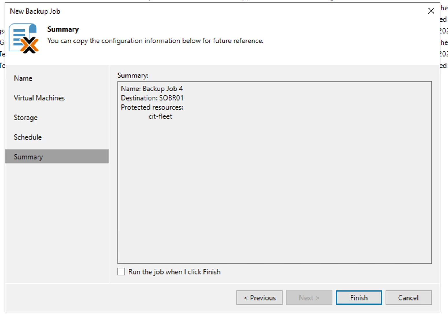

If you haven’t tried already, I’d first try creating the job with no schedule (uncheck run job automatically) and then edit the job and convert it.  I’d also try recreating the job from scratch.  Third option would be to try and copy and existing job, but it appears that this may be your first Proxmox job, so I don’t think you’d be able to copy the job.

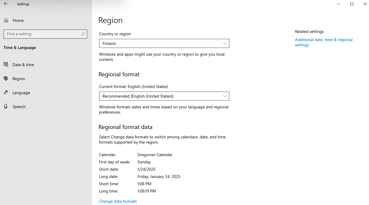

It appears that that when Veeam creates the job it actually converts the time format from the system environment format to the format of hh.mm based on my screenshot below.  I tried putting one of my servers into 24h time and 12h time and both result in no errors.

I did run into same issues when trying to create job with Veeam B&R 12.3.0.310. The problem here is that Veeam is using your Windows Date & Time settings, after just changing regional settings from whatever language / time you are using to English (United States) it starts working just fine.
This seems to be a bug, as Veeam is not checking your time settings correctly when doing Proxmox VE Backup job.
In my case, I changed Date format from Windows from Finnish → English (United States) and was able to do the job after that.

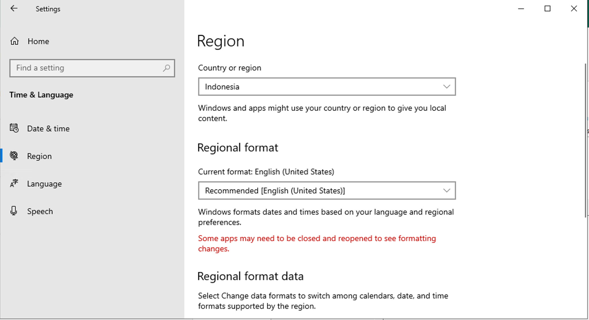

@Sakari Anttonen Finally it’s working now.
you are right after we change region format to US
Now we are able to create the job.
