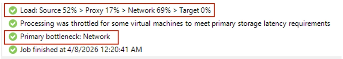

I agree with both takes here ​@Rendym . Reach out to a Veeam TAM or Support to get Job design assistance. But no doubt your wifi is more than likely the bottleneck. Wifi has more limited bandwidth than hard-wired connections.
In the Backup Job history (double-click the Job), at the bottom of the task list (Action column) in the right window, what is shown as the bottleneck? There are 2 tasks to take note of at the end of the Job → “Load: Source: x% > Proxy: x% > Network: x% > Target: x%”  ; and “Primary Bottleneck: <one of the ‘Load’ options will be listed>”. What are the given percentages and what is Veeam stating is the bottleneck. From these 2 items is where you start your performance troubleshooting.

Below is an example what I’m suggesting you look at:
Job Performance Action Items
The above is an example of a Replication Job I have. I use “hotadd” as my Backup Method, and this of course goes across a long-range LAN with fiber between, but even so...network is still my bottleneck because of the distance the data traverses. But, I don't really have performance issues. The Job runs pretty fast.
