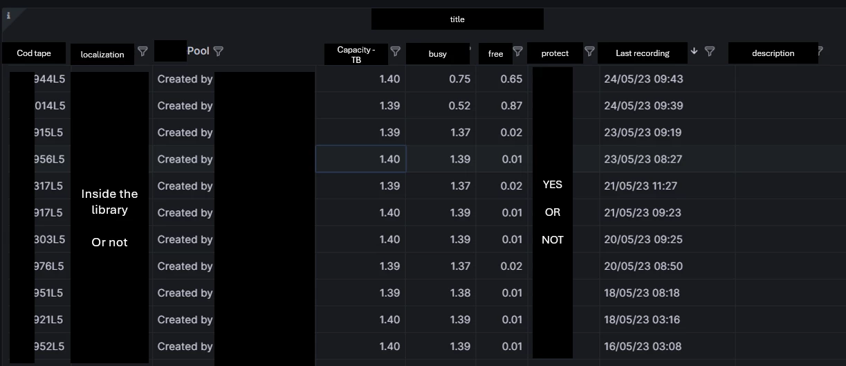

Hello! ​@Chris.Childerhose
We have developed a tape dashboard for Grafana.
All collections are made via Select in the Veeam database. Here we can track:
- Which tapes are inside or outside the library
- Which pool it is in
- Capacity
- Whether it is occupied or not
- How many TB are free
- Whether it is protected or not
- Last recording - Description
As the panel is in Portuguese I created some bullets to show you how it looks:
Remember that the panel is completely live.
When a tape is removed or inserted, I can already monitor it through Grafana.
This has changed the way we manage clients who use tape.
We have saved a lot of time for tape operators.
We have a TV that is always on and anyone who needs to monitor the library has the information displayed and live.
Is this something you need?

I have a similar requirement from one of my customers using tapes onsite….
When there is some time, I will write it… 😎 But time is a great problem...
This is something I would be interested in as well.
