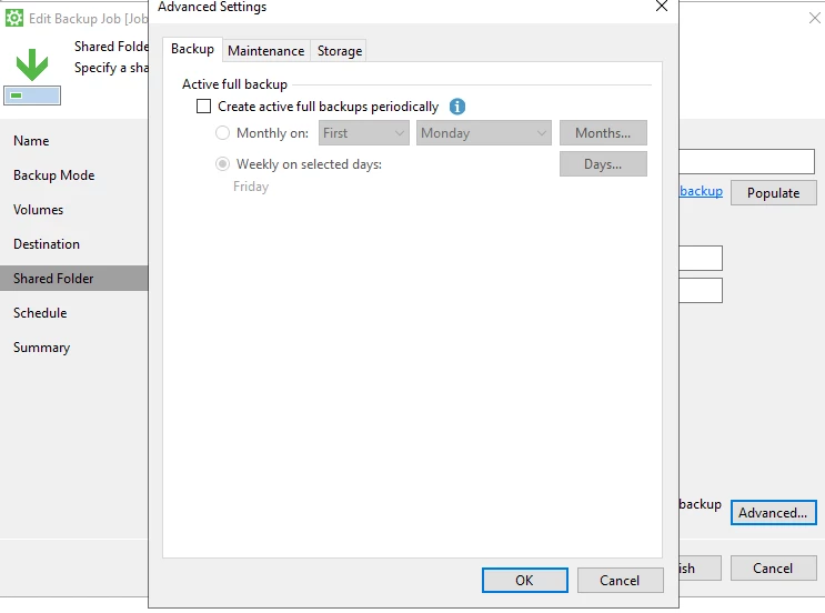

This is what I have on my advanced settings in my app.
On the schedule tab yes but check the Destination step two back.  That is what I mean.

@Esayas.T - review the links I provided above, and more specifically, the 2nd link. They tell you exactly how to configure the Job the way you want it to be (Forward Incremental), and shows you where the Advanced button > Backup tab is to configure the needed Backup Method settings. Screenshot what you have so we can help you verify.
@coolsport00 This is what I have in my advanced button > Backup tab, so how can I configure the forward incremental backup?
