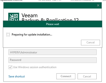

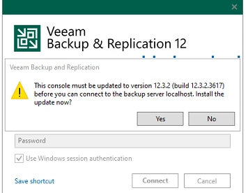

Hi Veeam team,

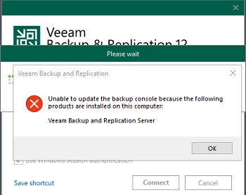

I recently upgraded our Veeam Backup & Replication server to version 12.3.2.3617 on a Hyper-V host (not ideal, I know). The upgrade failed. Upon reviewing, the VBR has been upgraded, but the console won't connect. An attempt to upgrade console will end up in the following error
“Unable to update the backup console because the following products are installed on this server: Veeam Backup and Replication Server”
Checking the logs, it says:

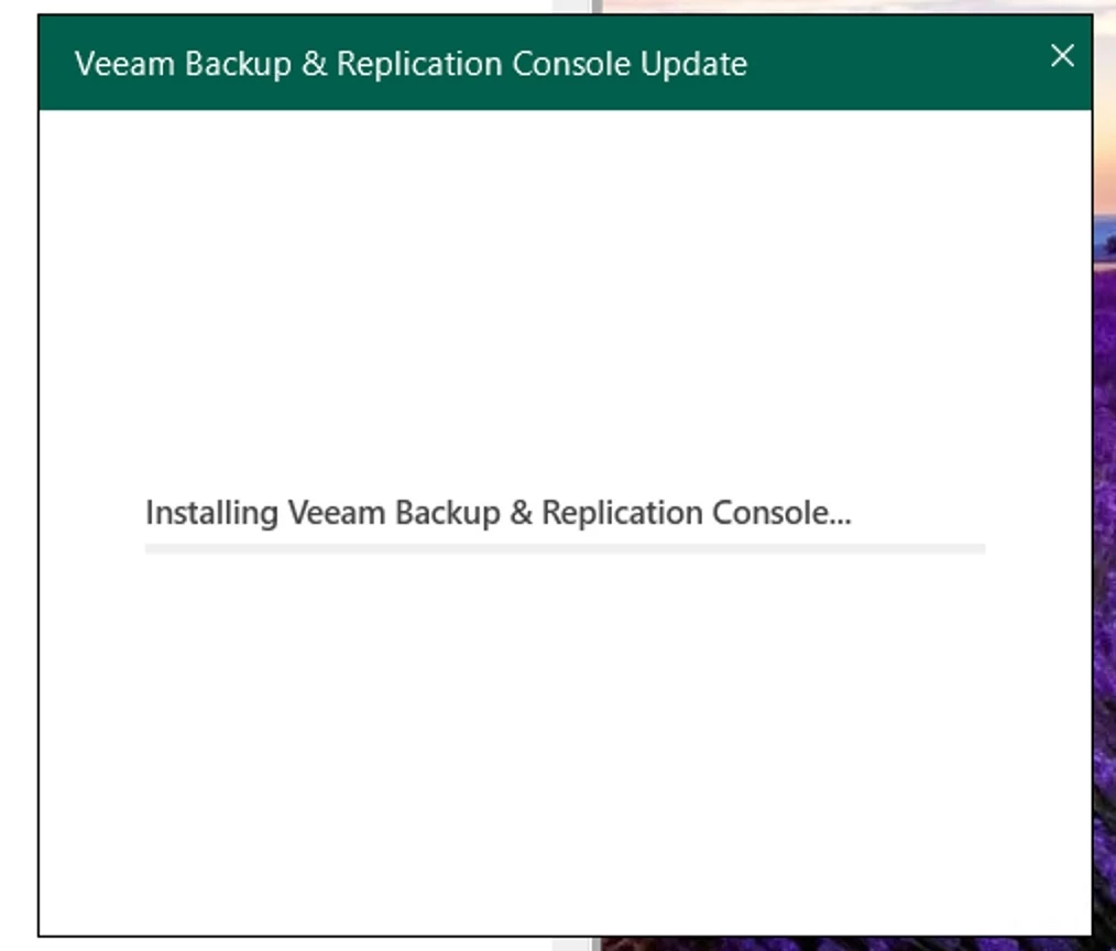

[04.07.2025 05:09:16][INFO] Installing Veeam Backup & Replication Console
[04.07.2025 05:10:52][ERROR] Fatal error during installation.
Steps I’ve already tried:
  • Rebooted the Hyper-V host
  • Force-stopped all Veeam services and processes
  • Tried installing console via both GUI and from ISO
  • Verified version mismatch (Console still on 12.3.1.1139, Server is 12.3.2.3617)
  • Confirmed no backup jobs are running
    Still stuck in a loop where the console can’t connect or be upgraded, even after a clean reboot. Would really appreciate guidance or some kind of cleanup tool to reset or force the console install.

Yes, the Backup service is running, with all other related services. But when I launch the console, it comes up with a version mismatch and prompts for an update, which then fails to complete. I'm unsure why the Veeam Server, which is installed on the same machine where the console previously ran without any issue, is now having this problem.

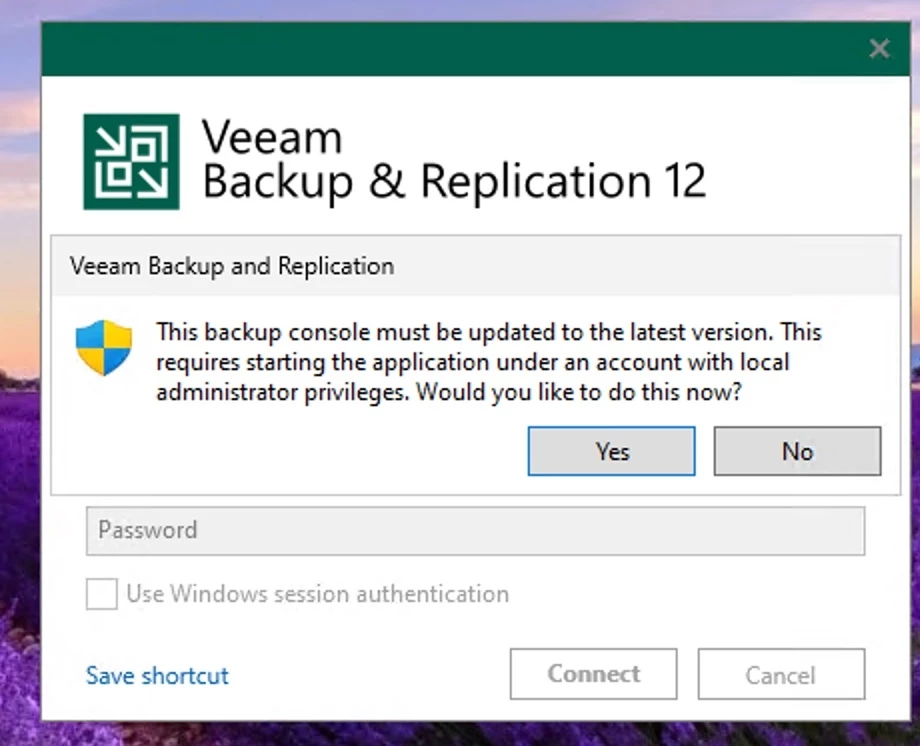

May I ask if the application is running under an account with the appropriate local administrator’s privileges?
