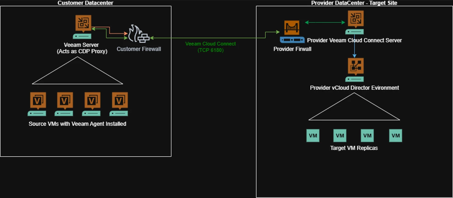

Design and Key Components
On the customer side, Veeam CDP Agents are deployed to machines in a protection group from a Veeam Backup and Replication (VBR) server installed at the customer site. These agents can then be added to a CDP Policy within the VBR server, and the agents use the VBR server as a CDP Proxy.
On the Service Provider side, the connection is received by Cloud Connect Gateways, routed through to the target CDP proxies, and ultimately written to ESXi hosts via VMware I/O Filters. Veeam coordinates the import of these VMs into vCloud Director.
Design Overview

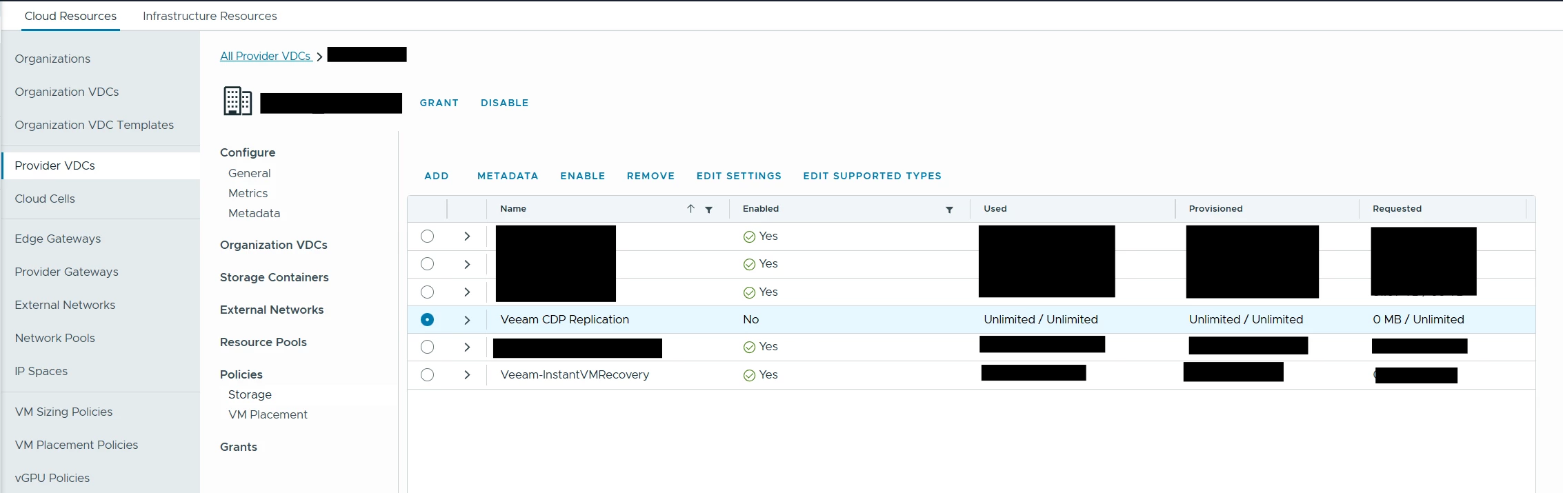

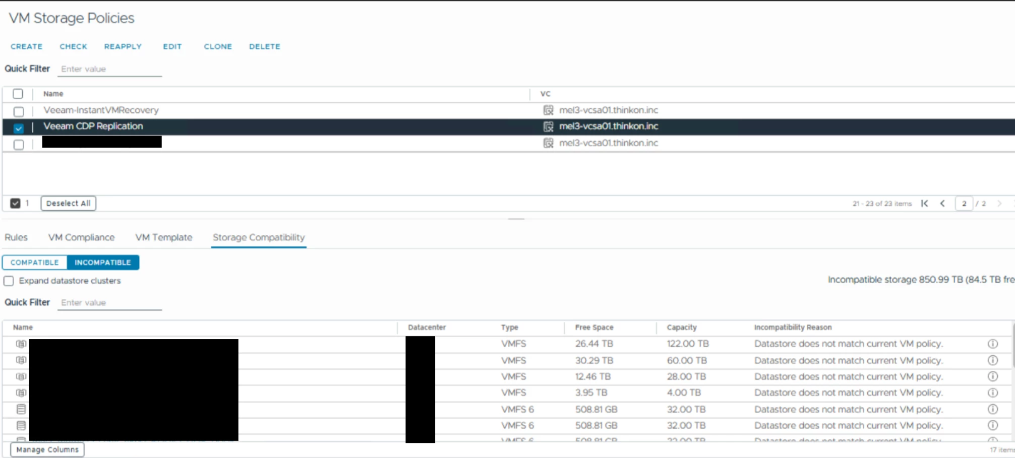

Unable to Select a Storage Policy for the CDP Replica
Symptoms:
No storage policy appeared when configuring the target replica.
Root Cause:
Some ESXi hosts connected to the datastore did not have Veeam I/O filters installed, making the datastore incompatible.
Resolution:
  • Installed I/O filters on all relevant hosts
  • Ensured datastore alignment across all clusters
  • Added policy to Provider VDC and tenant VDC
Incompatible Datastores for CDP Replication

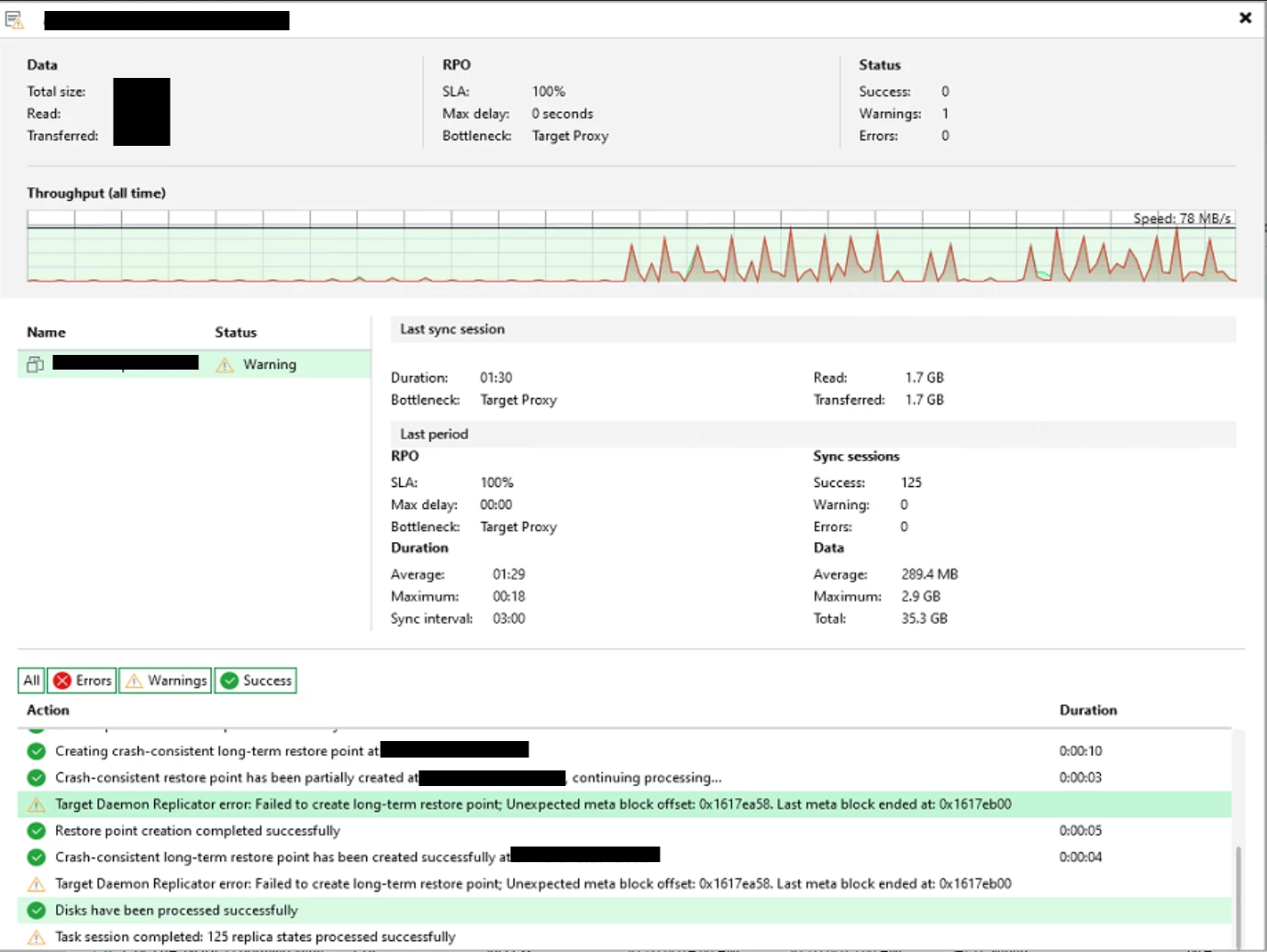

CDP Warning Blocking Failover (Long-Term Restore Point Error)
Symptoms:
  • The replica job showed the following warning every time a "long term restore point" was created by the policy:
    Warning : Target Daemon Replicator error: Failed to create long-term restore point; Unexpected meta block offset: 0x1617ea58. Last meta block ended at: 0x1617eb00
  • When attempting to fail over to the target replica, it was not successful
Root Cause:
No definitive root cause was identified. We suspect that there was some kind of metadata inconsistency between the source and target virtual disks.
Resolution:
  • Temporary workaround:
    • Delete the replica, recreate and resync
  • Long-term outcome:
    • Even with a new replica, the issue reoccurred after a few hours, making this unreliable for the customer's cutover window
    • Switched to using Agent Based Backups and Restore using Cloud Connect for the affected VM
