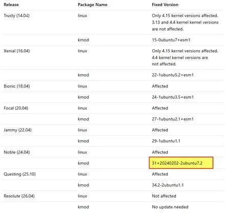

Fixes available for CVE-2026-31431 (Copy Fail) Linux Kernel Local Privilege Escalation Vulnerability | Ubuntu

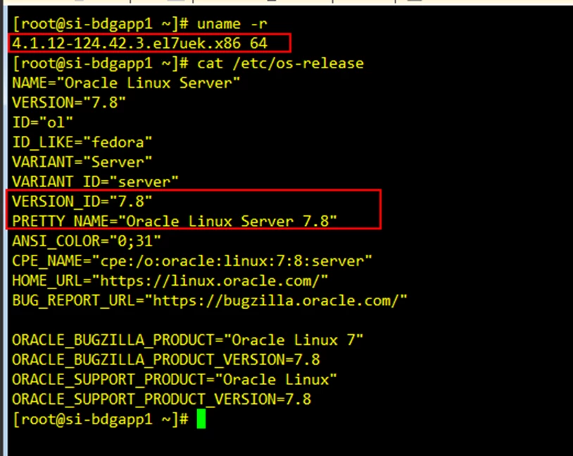

Displays the version of the Linux kernel currently running.
Check kmod and
This command queries the DPKG package database and shows whether the kmod package is installed, along with its version, architecture, and description.

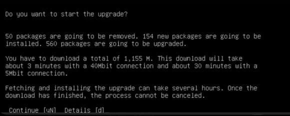

The "Big" Upgrade (Ubuntu 24.04 LTS)
Since you are on 22.04.5, the most stable way to get a newer permanent kernel path is to upgrade the entire OS to Ubuntu 24.04 LTS. This will officially move your system to the 6.8+ and eventually 6.11+ official support tracks.

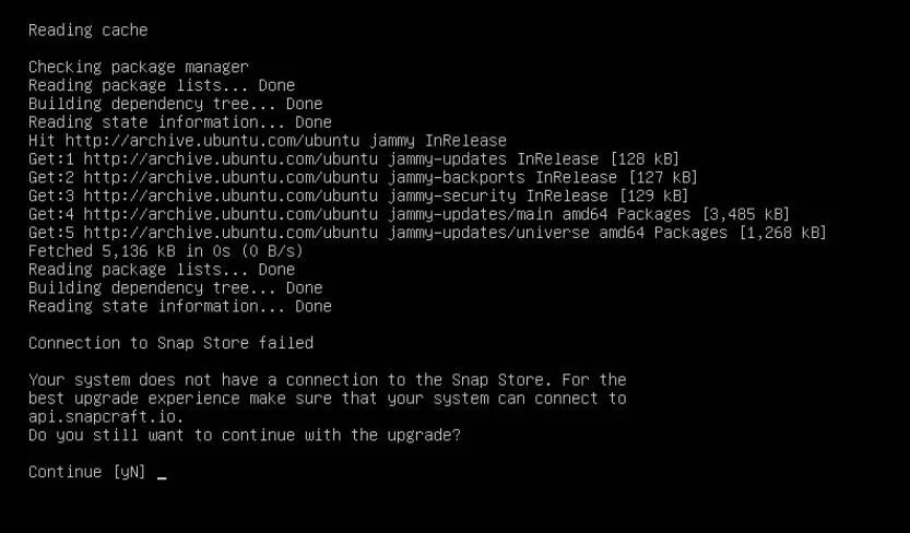

To check if the upgrade is ready for your specific machine, run:
sudo do-release-upgrade
Press Y
Press Y

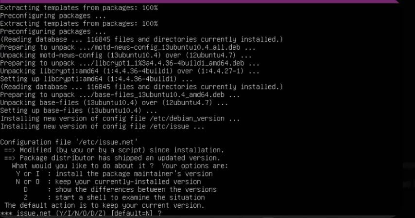

We are in the middle of the upgrade to Ubuntu 24.04. At this stage, the system is asking what to do with some configuration files that have been modified (in this case, /etc/issue.net, the file that displays the banner before login).
What should you choose?
For a server of this type, the safest and most common choice is:
  1. Press N (or simply ENTER): this will keep your currently installed version of the file (“keep your currently-installed version”). This is the best choice if you customized the server banner or if you do not want to change the login messages.

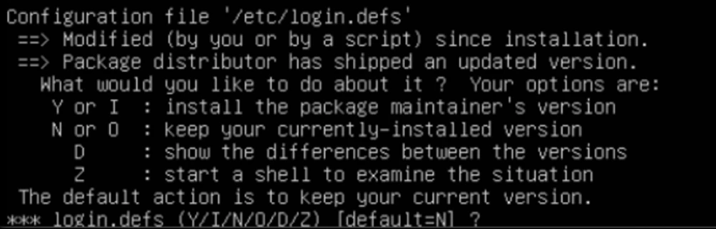

We are still following the same approach as in the previous steps. The file /etc/login.defs contains system-wide settings for password policies, user ID ranges, and account expiration.
Press N (or simply ENTER).
Why?
In a Veeam Hardened Repository, this file is almost always modified to increase security (for example, to enforce a minimum password age or stricter password complexity policies).

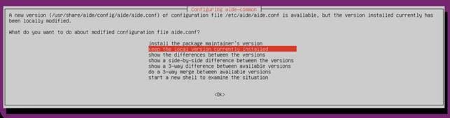

This file is related to AIDE (Advanced Intrusion Detection Environment), a fundamental tool for file integrity monitoring. If this is a Veeam Hardened Repository, AIDE is specifically configured to send alerts if someone attempts to tamper with backup or system files.
Make sure “keep the local version currently installed” is selected (as shown in the screenshot) and press ENTER on <Ok>.
Why?
  • Custom Configuration: The AIDE configuration on an immutable repository is highly specific. Overwriting it with the package’s “standard” configuration could stop monitoring the correct directories or generate thousands of false positives.
  • Integrity: By keeping your local version, you ensure that the integrity monitoring system continues to operate exactly as configured during the server hardening process.

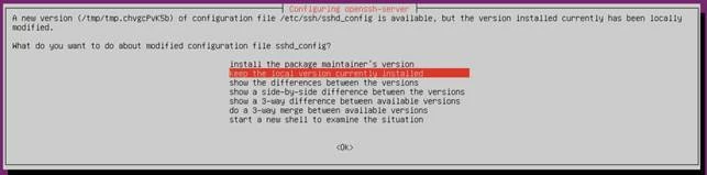

This is an extremely critical point for your server’s security. The file /etc/ssh/sshd_config controls remote access via SSH.
Make sure “keep the local version currently installed” is selected and press ENTER on <Ok>.
Why is this essential?
In a Veeam Hardened Repository, SSH access is often restricted or configured with very strict security parameters (such as disabling root login, allowing key-based authentication only, or using custom ports).
  • If you choose the “maintainer’s version” (the new one), you may restore Ubuntu’s default settings, potentially opening security vulnerabilities or, worse, locking yourself out of the server if your current access method is no longer supported by the standard configuration.

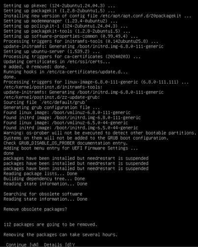

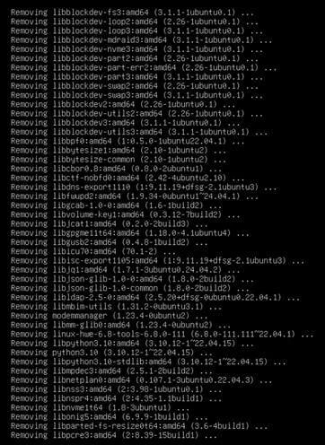

We have reached the final cleanup phase. The system has successfully updated the boot files (you can see that it generated the new files for kernel 6.8.0-111-generic).
What to do now:
Press y (Yes) and then ENTER.
What is happening:
  • Remove obsolete packages?
    The system has identified 112 packages that belonged to the old Ubuntu version (22.04) and are no longer needed in the new one (24.04).
  • Removing them is essential to keep the server clean and secure, and to avoid conflicts between old and new libraries in the future.
  • Even though the message says it “may take several hours,” for 112 packages on a server of this type it usually takes only a few minutes.

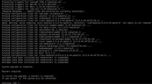

Press Y

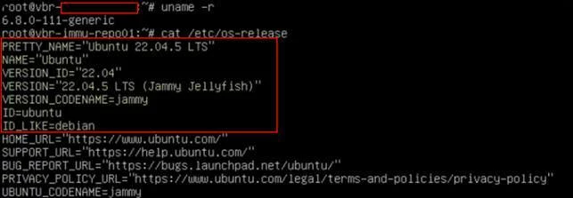

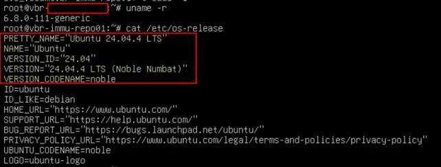

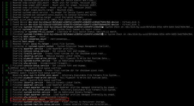

The message “System upgrade is complete” confirms that the entire process has finished successfully. You have just upgraded your server from Ubuntu 22.04 to Ubuntu 24.04 LTS, applying all the latest kernel security patches in the process.
What to do next:
  1. Type y and press ENTER to reboot the server.
  2. Wait a few minutes for the server to come back online.

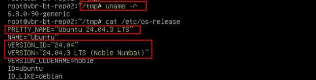

  3. Log in and verify the final result using this command:
    • uname -r (you should see the new patched kernel)
Why did the kernel remain the same?
The 6.8.0-111 kernel is the stable, flagship kernel used both at the end of the Ubuntu 22.04 lifecycle and at the beginning (and current point releases) of Ubuntu 24.04.

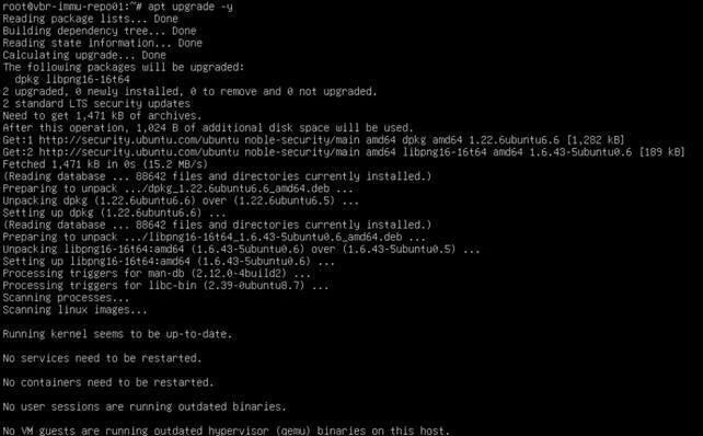

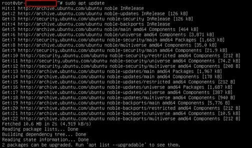

How to verify that everything is fully up to date
To be 100% sure that there are no additional pending kernel updates (now that you are on 24.04), run these final commands:
sudo apt update
sudo apt list –upgradable
There are two security updates still pending specifically for your new release (noble-security). One of them concerns dpkg, which is the core of the package management system.
apt upgrade -y
dpkg -l kmod
fixed
Run a rescan of your VHR and proceed with the backup for verification.
