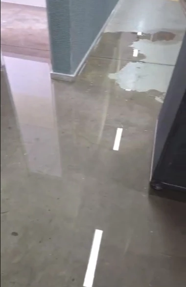

As soon as I entered the area, I noticed water across the floor.
At first, I assumed it was a minor leak.
Nothing unusual.
But as we continued investigating, it became obvious that we were dealing with something much more serious.
There wasn't just a small puddle.
There was a significant amount of standing water throughout the area.
Standing water had accumulated throughout the area, suggesting the problem had been developing for days rather than hours.
The volume of water became much more apparent during the inspection.
The longer we looked, the more concerning the situation became.
And then another realization hit us.
This hadn't happened overnight.
Based on the condition of the area, it was very likely that the problem had existed for several days.

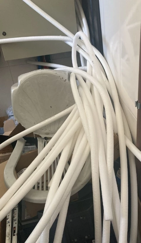

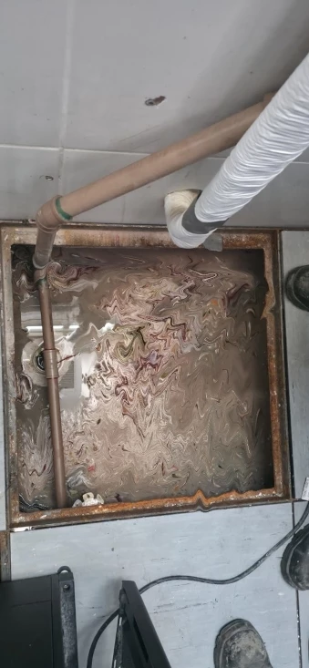

The facility relied on multiple air conditioning units to maintain environmental conditions.
As expected, those systems generated condensation that needed to be drained away through dedicated piping.
At some point, the drainage system became obstructed.
Instead of removing water from the environment, the blocked line began forcing water back into the area.
As the situation worsened, residue from the sewage system also started flowing back through the same path.
What began as a maintenance issue gradually evolved into a flooding event inside a critical infrastructure environment.
Evidence of drainage failure and contamination found during the inspection. I distorted the image and marked it as a spoiler because it contains graphic content.
The issue was no longer about condensation.
The issue was that water and contaminants were now present inside a room supporting critical IT operations.

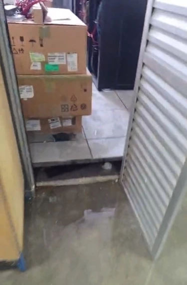

Most modern facilities rely on raised floors to route power and communication cabling.
This environment was no different.
Below the raised floor were power cables, network connections, and infrastructure supporting critical services.
At one point during the inspection, I realized that water was accumulating in the same area where those cables were routed.
That was the moment the situation stopped looking like a maintenance issue and started looking like a business continuity risk.

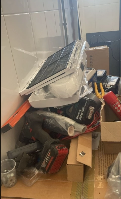

When a Data Center Becomes a Storage Room

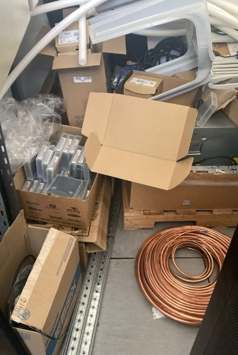

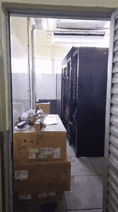

As the inspection continued, another problem became impossible to ignore.
The room was no longer being treated exclusively as a critical IT environment.
Boxes, packaging materials, installation supplies, spare components, and miscellaneous items had accumulated throughout the facility.
The first signs that the room was no longer being treated as a controlled environment.
Various materials unrelated to IT operations had gradually accumulated inside the facility.
At first glance, these may seem like minor issues.
But this is exactly how many operational failures begin.
Nobody intentionally decides to turn a data center into a storage room.
Instead, it happens through a series of small exceptions:
"Let's leave this here temporarily."
"We'll move it next week."
"It's only one box."
"It won't cause any problems."
Over time, temporary exceptions become permanent conditions.
The flooding incident simply exposed problems that had likely existed for much longer.
